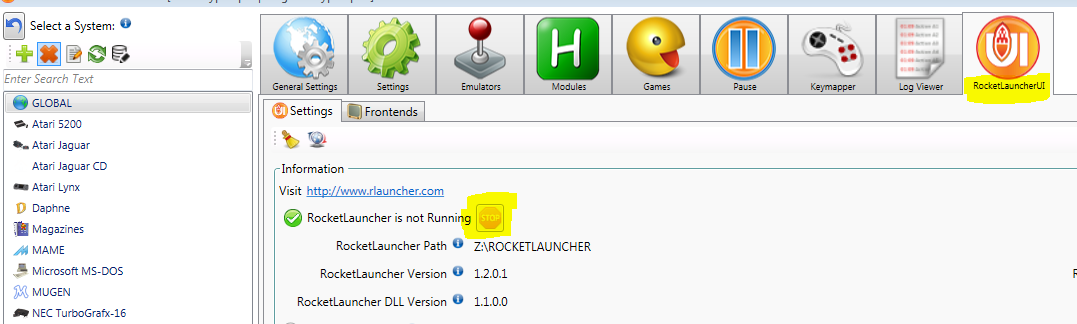

Maybe check and see if rocketlauncher is already running in the background. Given the enter key gets you into your game list, sounds like a problem between HS and RL. If RL hangs after exiting an emulator, it will not start the next time you start something.
If running, yes it should show in task manager, but easier still is here:
Even has a button to kill it if it is running!
Anyway, that log shows that enter IS working, you pushed it 5 times :-) So it sounds like RL is not receiving the command from HS.

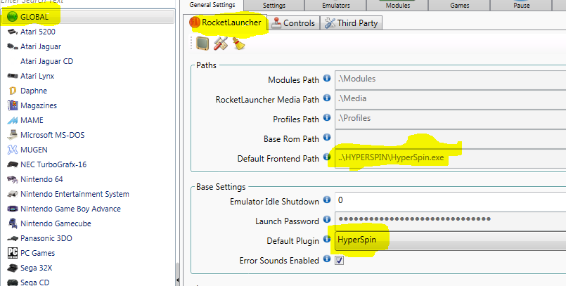

Without seeing an RL log (not that I am very good with them anyway), I would suggest checking here for active and default:

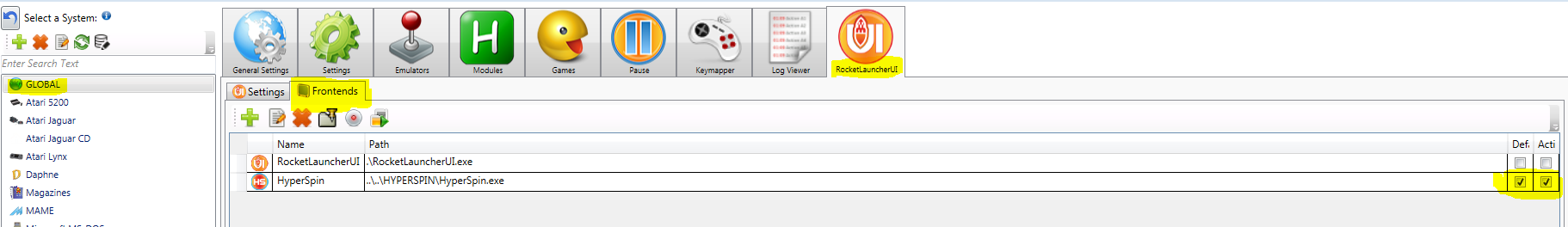

And here:
Thanks Spawk.
Ok mine is different to that BUT thats how it has been since I installed it ( Initially I watched Doobreys video on Youtube  and it set up and worked perfectly - for 2 weeksthen stopped - hence this thread  ) - screenshot below.

So I am still lost as to why it did that , or if it will fdo it again ( I am currently bench building all this before I load PC into arcade cabinet and wire up controls etc - and now wondering do I need to adjust my settings below as they are different to what you showed ?
