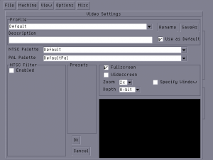

gigapig Posted May 22, 2014 Posted May 22, 2014 Someone MUST have this running fullscreen??? Yes. Either run the wizard again or set it to Fullscreen and Zoom 2x

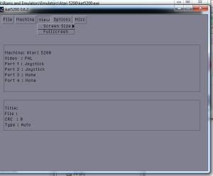

gigapig Posted May 22, 2014 Posted May 22, 2014 Tried everything gigapig, to no avail.I'm running my HyperSpin PC through my AV receiver so I'm sure that's the problem... Even command line doesn't seem to change anything... Try clicking "View" and check fullscreen there.

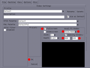

bandit721 Posted May 22, 2014 Posted May 22, 2014 I have mine running fullscreen on a 24" widescreen LCD. I'm using the NTSC filter which enables an available resolutions drop-down to the right of the video setting screen. My monitors native resolution is in the list, so that's what is set to. I also have the "fullscreen" checkbox selected. Not sure if you've tried enabling the NTSC filter or not.

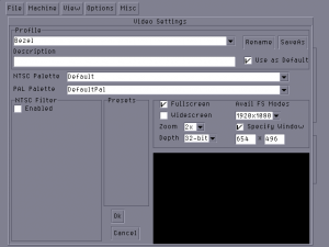

gigapig Posted May 22, 2014 Posted May 22, 2014 My biggest problem is making it full screen and 4:3. There's no real good option. You've messed with these options? It gives you black bars all round or on the sides, shame bezels don't work yet with Kat. Select from the Avail FS modes and click OK.
OneBadVeggie Posted May 23, 2014 Posted May 23, 2014 I basically just get a box in the center, so it's surrounded by black. Maybe I can get a screen shot... edit: Holy crap, I've actually found settings that give me a 4:3 look. Check it out. Can't get a screen shot, but I have black bars on the sides, but none on the top. Looks good.
