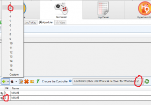

ninja2bceen Posted July 18, 2014 Posted July 18, 2014 Hi I have 2 ps3 controllers working with 2 players in fusions emulator for example. However when I use hyperspin to launch I can never get both controllers to work. I have read countless wiki and file structure but I can't figure it out. Note that I can use both controllers in RocketLauncher and hyperspin. Once I load fusion for example from hyperspin, a controller stops working. If I load fusion outside of hyperspin both controllers work. What could I be doing wrong? Advance the cause to 100%. http://hyperbase.hyperspin-fe.com/ Planet Geekdom, Subscribe for Tutorials! https://www.youtube.com/channel/UCdcby-s2GwriaOHGmVC2vGA?sub_confirmation=1&app=desktop
twmac Posted July 22, 2014 Posted July 22, 2014 Hi I have 2 ps3 controllers working with 2 players in fusions emulator for example. However when I use hyperspin to launch I can never get both controllers to work. I have read countless wiki and file structure but I can't figure it out. Note that I can use both controllers in RocketLauncher and hyperspin. Once I load fusion for example from hyperspin, a controller stops working. If I load fusion outside of hyperspin both controllers work. What could I be doing wrong? When your making the second profile for p2 are you making sure to choose the second controller before you make the second profile?
showstopper Posted July 22, 2014 Posted July 22, 2014 How i have managed to set my pads up is to only use xpadder for P1. Configure P2 in the actual emulator and P1 through xpadder. How to update HyperLaunch
ninja2bceen Posted July 22, 2014 Posted July 22, 2014 When your making the second profile for p2 are you making sure to choose the second controller before you make the second profile?[ATTACH=CONFIG]42658[/ATTACH] Thanks, I was just using xpadder for the set up and not select controller. This worked! Advance the cause to 100%. http://hyperbase.hyperspin-fe.com/ Planet Geekdom, Subscribe for Tutorials! https://www.youtube.com/channel/UCdcby-s2GwriaOHGmVC2vGA?sub_confirmation=1&app=desktop
