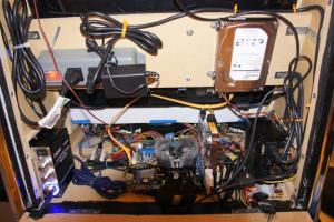

nephilim Posted June 3, 2014 Posted June 3, 2014 Hi Guys, When it comes to powering bartop arcades, is there any better (smaller) option than this: http://www.amazon.com/Smart-Energy-Saving-Autoswitching-Technology/dp/B000P1QJXQ Has more outlets than I'm going to need and it's pretty large... but as I understand it, using this will allow me to power everything on/off via the computer (master). Also, to anyone that's used one, where do you end up putting it in your bartop? Between the mobo/control panel? Or attached to the side? Thanks, Owen Newoski, for what its worth, I used a very simple Power strip from Tripp Lite. since it had a fuse, was metal cased, 6ft cable, and could be drilled into would frame easily. I didnt need more than 3 outlets, as harnesses were USB. So the only components to plug in were Mobo and amplifier. http://www.amazon.com/gp/product/B000F99CJG/ref=oh_details_o07_s01_i07?ie=UTF8&psc=1 Here is how it looks in the back of the bartop: Nephilim - Sasha Killz [sIGPIC][/sIGPIC]
nephilim Posted June 3, 2014 Posted June 3, 2014 Hi Guys, When it comes to powering bartop arcades, is there any better (smaller) option than this: http://www.amazon.com/Smart-Energy-Saving-Autoswitching-Technology/dp/B000P1QJXQ Has more outlets than I'm going to need and it's pretty large... but as I understand it, using this will allow me to power everything on/off via the computer (master). Also, to anyone that's used one, where do you end up putting it in your bartop? Between the mobo/control panel? Or attached to the side? Thanks, Owen Newoski, for what its worth, I used a very simple Power strip from Tripp Lite. since it had a fuse, was metal cased, 6ft cable, and could be drilled into would frame easily. I didnt need more than 3 outlets, as harnesses were USB. So the only components to plug in were Mobo, monitor and amplifier. http://www.amazon.com/gp/product/B000F99CJG/ref=oh_details_o07_s01_i07?ie=UTF8&psc=1 Here is how it looks in the back of the bartop: [ATTACH=CONFIG]41653[/ATTACH] Nephilim - Sasha Killz [sIGPIC][/sIGPIC]
