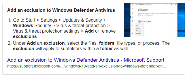

Spawk Posted August 29, 2018 Posted August 29, 2018 Yep, expected behaviour. Add the entire HS folder as exception:
