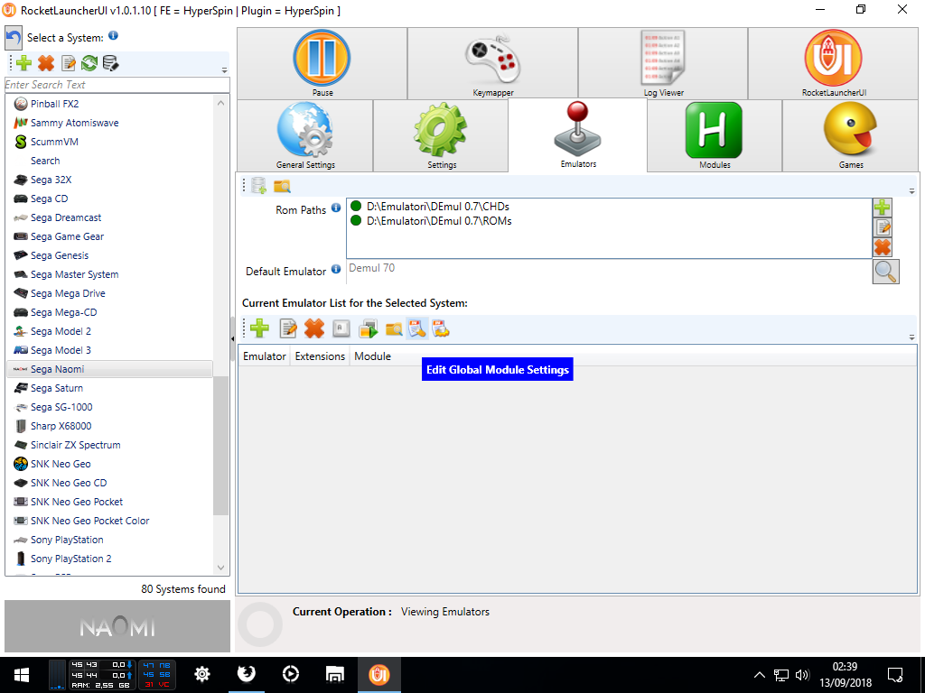

RLBradders26 Posted September 13, 2018 Posted September 13, 2018 Just edit the controls in the Demul Module Settings to whatever you want.
hassen Posted September 13, 2018 Author Posted September 13, 2018 Thanks to respond but i need some screenshots to understand what you want me to config, it will help me a lot !!
