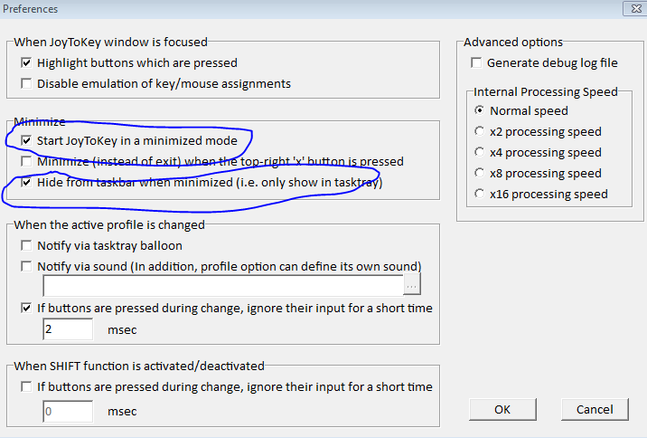

1. Start JTK from your "Windows Startup" folder so it is loaded (and minimized to tray) long before you even start HS. Create a shortcut from the JTK.exe and drag/copy it to "Start Menu" --> "All Programs" --> "Startup" folder.

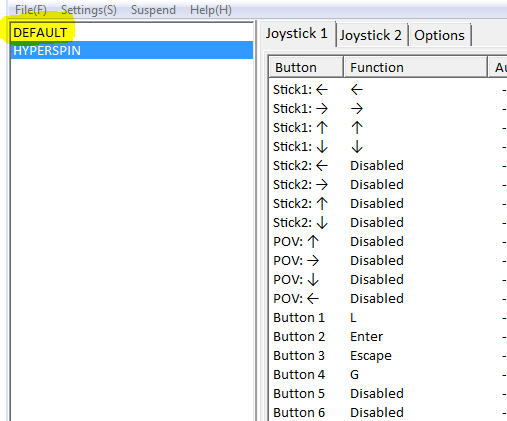

2. Now contrary to intuition, we will only have 2 profiles in JTK itself. A "DEFAULT" (completely blank) profile. I use this profile when I boot so the buttons on my joystick don't send accidental "enter" and "escape" keypresses in windows apps! And an initial "HYPERSPIN" profile (we only need this as when you first run HS, RL has not run yet till you choose a game). Something like this:

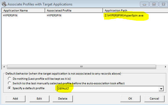

ALL other profiles will be made and stored inside RL. First let's make it so the HS profile automatically starts when you first start HS:

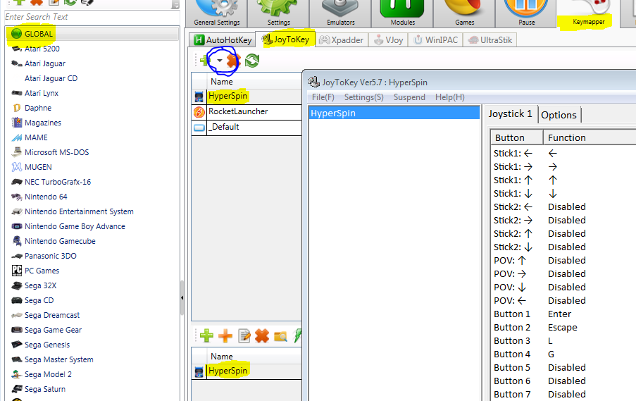

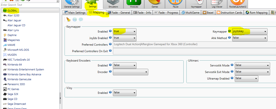

All right, now let's setup RL. First tell RL where JTK is located:
And we'll enable it globally:
Now we can set up some fundamental profiles. You'll want to create all 3 available profiles (Default, Frontend, and RocketLauncher) by clicking the down arrow here:
Now select Hyperspin in the top pane and Hyperspin in the bottom pane (plus sign if you need to create it) and make it exactly like the profile you made directly in JTK earlier (you may notice that I have my buttons mixed up in these pics ironically LOL... one of these pics was old that's all). The RL profile is used for the controls when in "Pause" and I believe the _Default profile is simply only used whenever it has no other profile to load. Should be left blank.

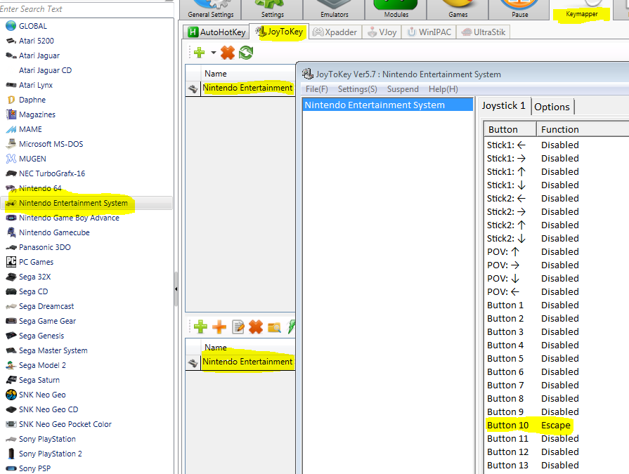

Also, some emulators like Mame allow you to set the exit emulator key so you can just map it directly to a button your gamepad. Most other emulators don't though and you can set up profiles to send the "escape" key (the default exit emulator key in RL) from your gamepad like this:
This example used NES but it has to be repeated for every system that needs an exit mapped. Doing it like this is good though as i had another emulator I like to use just not want to exit with the escape key. I simply mapped Alt+F4 to that button for that system. Problem solved. :)

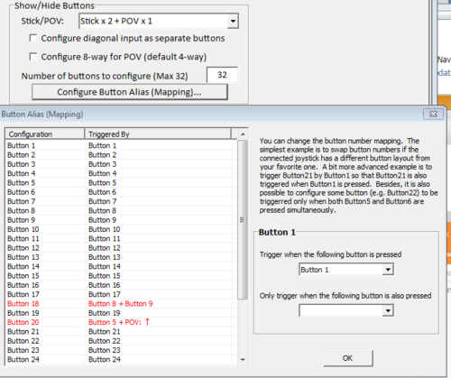

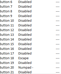

Just want to add that in case all your gamepad buttons are already in use and you want to make a button combination to send the escape key you can do it like this:
My gamepad has 12 buttons on it. So I can choose a button higher than this in JTK (I will randomly choose 18) and assign my desired effect to it: "escape"
Now under the options tab select "Configure Button Alias (Mapping)" and with button 18 highlighted assign your desired combo (say Select and Start are buttons 8 and 9).
In this scenario you need to hold button 8 down and then hit button 9 to send the "escape" key.
You can also repeat this for other commands like the disc change key (default is NUMPAD -) and assign another combo:
And you are not limited to just other button presses as well:
Here you would have to hold the 5 button and tap up on the POV.
