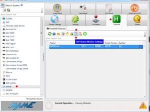

If you have hlsl enabled in the ini that won't make a difference when run through Hyperlaunch, you need to navigate here and change the HLSL setting to true.
[ATTACH=CONFIG]41726[/ATTACH]
[ATTACH=CONFIG]41727[/ATTACH]

Thanks pig. I eventually found these setting last night after messing around. So you are saying the MAME .ini file that is found in Hyperspin>Emulators>MAME> is in no way used by Hyperspin?
Last night I was just being "scientific" and took the ini from the aforementioned directory, and overwrote the one in HyperSpin>HyperLaunch>Modules>MAME (I named the .ini that already resided there to MAMEold.ini, as a backup)

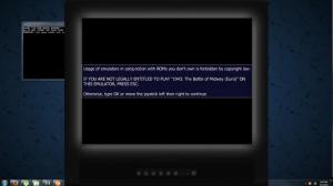

I was getting errors/blank screens. So I went back with the old file. Then I figured out how to set HLSL to "true" in HLHQ. but after setting that to true, I get this:
(Regarding my specific setup, typically, this would just be MAME in fullscreen, no borders, shaders, etc---and that's not even my desktop wallpaper....)
Now....what the hell happened there?
I went back into HLHQ, set EVERYTHING I could find back to false, restarted, and it is STILL there! The roms won't even load. It just goes to a black screen. What did I do? I was so proud of myself for finally getting everything to work, all the artworks, video snaps. ARRRGGGHH!!!:argh:
EDIT: Disregard everything posted above... I suppose at some point I played with the "bezel" settings..... Woopsy :facepalm:
Everything is working great now, shaders and all thanks pig!

You get a black screen if you set bezels to true and also to layout. If no mame artwork exists you get a black screen.
