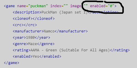

You can still get around this easily enough editing the database. I suggest "Notepad plus plus" (Notepad++). It's freeware and will make editing xml's a lot easier.
In the case of Pacman, edit this into the Mame.xml:
That will hide it from the wheel.
Then under the version of Pacman you want to use, simply remove "puckman" from in between the <cloneof> tags.
HS will now see that rom as a parent. Don't worry Mame itself still knows what's what  :)
