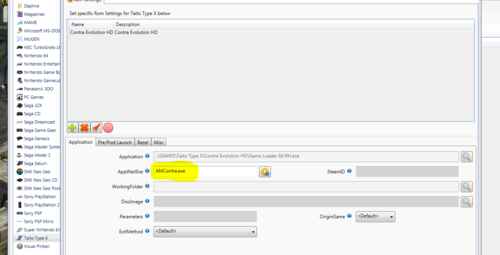

KTMSPARK Posted September 13, 2019 Posted September 13, 2019 Hi Guys , After much reading and trawling , I still not have discovered how to fix this issue on some games. I understand that if u get the Error ahk_pid 13244 you go thru the ctrl-Q appwait setup and choose one of the programs that it shows running. My issue that with some games it does not fix it ? is there a plan b? I have some ideas but i dont want to mess until someone in the know can confirm it might work idea 1: Turn off fade ? idea 2: set fade to have longer loading delay time? idea 3 : create a batch file that points to the exe? ( i know doubtful) Idea 4 : accept that some games cannot be fixed and go get a beer The latest game im having this issue with is Virtua Fighter 4 running thru Gameloader all rh.exe. ( this game runs fine outside of HS) the other 2 pc games that refuse to be tamed are Tetris Effect, StreetFighter 5 and Urban Trial Playground . With the help from this forum and much reading , I have configured much more complex things than this error , but im struggling with these . Thanks to anyone who can help me solve this and put me out of my misery
Spawk Posted September 18, 2019 Posted September 18, 2019 No answers here? I have not messed with TTX all that much but I assume you mean settings here? So with these games there is no extra exe? or more than 1 to chose? Just curious. Hover over the exclamation points for more info. If you can add the game to Steam I don't think you need filenames at all just the ID numbers. If you find a solution please share
KTMSPARK Posted September 18, 2019 Author Posted September 18, 2019 I managed to find a fix to this happening , i set a fade title , then set fadetitle wait till active to FALSE and it works
