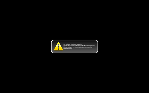

Followed the guides (very useful) but must have gone wrong somewhere.
Hyperspin and rocketlaumcher are workin but when I go into a mame game I get No default Emulator found in c:\rocketlauncher\settings\mame\emulators.ini but I dont have a emulators.ini in that location in fact I dont have a mame folder, I also getthe same when trying atari 2600 games.
Can anyone help?

you are using a "local" emulator  or have yet to assign an emulator to your system
use global emulator
you should have this
RocketLauncher\Settings\Global Emulators.INI
if you don't  make a copy of this
RocketLauncher\Settings\Global Emulators (Example) .INI
and rename it to
Global Emulators (Example) -->  Global Emulators
you will need to updated ALL!!!!! the emulator paths to match your set up.
and change your default emulator (per system)  to global
