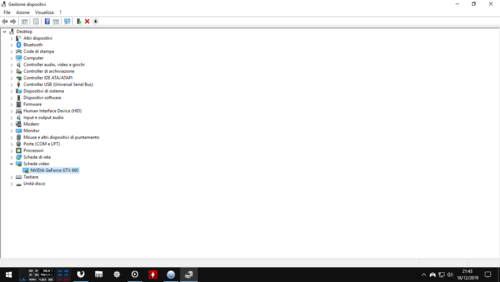

dark13 Posted December 16, 2019 Posted December 16, 2019 What do you see in "devices"? Usually the integrated video card is not usable no visible when a pci-e videocard is connected but on a pre-assembled desktop there might be some software that permit to switch from one videocard to another like in some laptops Automatizing infopanels creation from .csv files for HTPCs themes (look at infopanel tutorial.zip on the ftp in dark13 folder) PNGs to SWFs automatized flash scripts Hyperspin Wheelset automatized template (photoshop's variables + batch) Aeon nox 4.13 W.I.P. hyperspin skin
