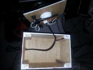

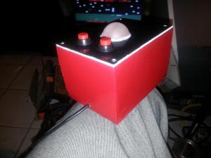

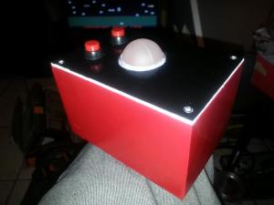

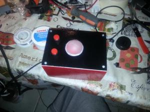

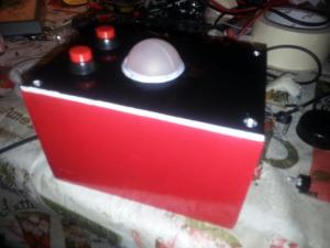

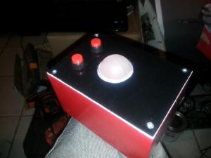

hello guys i thought i would share my small build of a mouse i turned into a trackball..
since i didn't want to spend a lot of money for a real trackball that i would only use on
occasion.. so i set out to build one i found on Google using a roll-on deodorant ball and an optical
mouse i bought at a local goodwill, some scrap wood and glue..
everything i used was stuff i had laying around or i bought but i spent less than $5 for the
build..

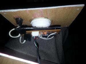

i was surprised how well it worked, it actually works better than i thought.. all i did was invert a few things
in mame and it works perfect.. on mine i also desolderd the tiny micro switches and hot glued them to a button on
top for whatever i needed it for..

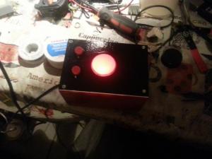

the ball does light up red but you cant really see it cause of the flash but i think it looks pretty good.. what are your guys thoughts?
i didn't really take pics while building it since i didn't think it would actually work well, but it did..
but maybe ill make a revised one and take pics along the way..
as for the link for where i got the idea just Google "optical mouse into trackball" and its an inscrutable..

Does it keep your hand from sweating? ....lol....no seriously. .nice work. That would work well for cabs with limited space .
Sent from my SCH-I545 using Tapatalk
Haha my hand is always dry.. but thanks guys I think this a good project for those who might not have a lot of funds maybe and still be able to play the games ..
