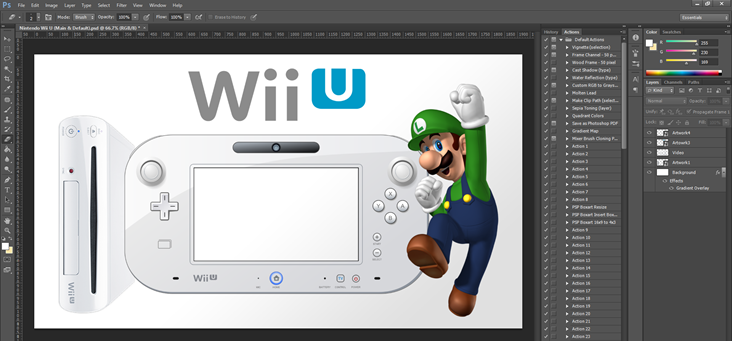

2)  Open your Background in Photoshop, the canvas size should automatically be 1920x1080. Drag and drop the rest of your artwork from the source folder into the Photoshop file. Move and resize your artwork (keeping the same proportions) until you get the theme exactly how you want it. Name each layer as to what they would be in Hypertheme. Background, Artwork1, Artwork2, Artwork3, Artwork4, Video.

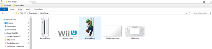

Artwork 1 to 4: Have only Artwork 1 visible, go to Image --> Trim, have top left pixel color selected as well as top,left,bottom right. This will shrink the canvas to the edge of each image. File save as Artwork1.png. Hide Artwork1 and do the same for Artwork2, then 3, then 4.
Video: Have only the video layer selected and go to Image --> Image Size, untick constrain proportions and change the width: 1024 height:768. Press ok and go to Image --> Trim, have top left pixel color selected as well as top,left,bottom right. This will shrink the canvas to the edge of the video. Save as video.png. You will end up with the following…

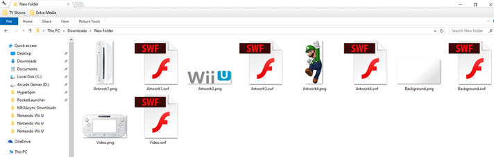

4)  Go to the folder where you saved Dark’s scripts, double click on PNG_to_SWF_dark13_1080p_scale_Artwork.jsfl, Flash Pro will open and ask you to select a folder. Select the folder from the above step. The script will convert the artwork and smooth. Once complete your folder will look this…
5)  Delete the video.swf file you do not need this. Delete Artwork1,2,3,4 and Background pngs.

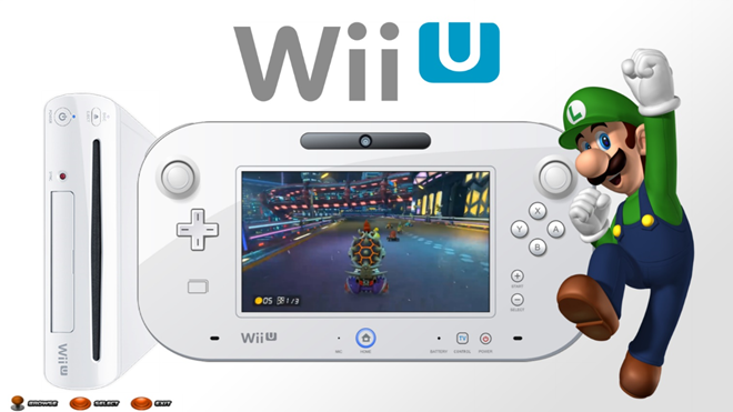

Open Hypertheme and use the swf files and video.png to create your theme as normal. Give yourself a pat on the back for making a good looking 16:9 theme.

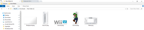

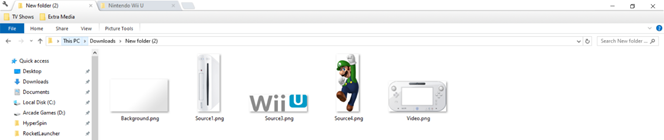

I save artwork 1-4 individually as you did but on a 1920x1080 canvas and run them through the PNG_to_SWF_Zero_Dreams_1920x1080_to_1024x768 script.
then edit artwork 1-4 in the xml to x="512" y="384" they will be in exactly the same place as you put them in photoshop.
