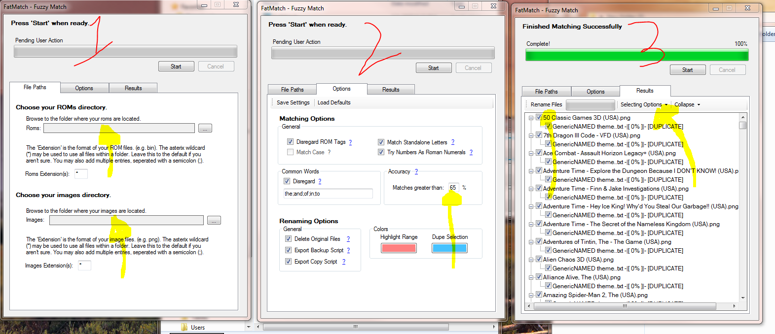

A quick question, I have downloaded several mame MP4 themes from the Emumovies FTP site, however, it appears there is not a download file available for the preconfigured romname.zip files.  I don't mind putting in the work and copying and pasting/and renaming a couple thousand times, however, if there is a more efficient way to do this (re-namer utility?), it would be great to hear about it.  Thanks for listening.
Download all the Video themes you want
Place them in a Temp Folder
Create a second Temp Folder and place your generic theme in it;  name does not matter
download Fatmatch
Start fatmatch.exe  and click on  "Start Match Wizard"
1.
Rom path  --->  Path  to your Video themes;  Make sure they match the MAME rom names!!!!!!!
Images path -->  Path to the folder that contains your single theme.
2.  Make sure!!!!!!   to change the value under "Matches greater then"  to ZERO!!!!!!!!!
3. Click Start at the top
Wait for the Program to scan your video files
from the Results tab
Click on "Select Options"  and select  "Select Best Matched"
Because you set your match to 0%  all your video files will be matched to your single generic theme
Click on "Rename Files"
Fatmatch will make duplicates of the single theme and rename them to match your video names.
