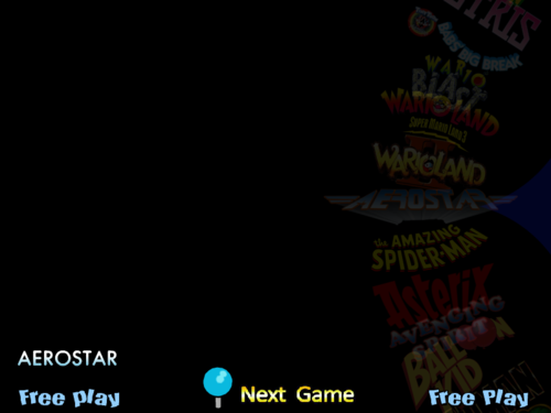

xvasman1 Posted September 10, 2020 Posted September 10, 2020 Hi, I've just created a new wheel for the gameboy on hyperspin, i put its themes, wheel, .. and the same for the games in the media folder. The main menu gameboy is ok but the emulator menu hides the video and artwork games, i can just see the wheel games. Someone would have a solution ? Thx in advance
Creezz67 Posted September 10, 2020 Posted September 10, 2020 30 minutes ago, xvasman1 said: Hi, I've just created a new wheel for the gameboy on hyperspin, i put its themes, wheel, .. and the same for the games in the media folder. The main menu gameboy is ok but the emulator menu hides the video and artwork games, i can just see the wheel games. Someone would have a solution ? Thx in advance Look in the themes folder and make sure you have a default.zip theme. Also go to HyperHQ and adjust the fade slider to show wheels clearer if required.
xvasman1 Posted September 10, 2020 Author Posted September 10, 2020 Hi, Thanks for your quick answer, i didn't note the default theme Have a nive day
