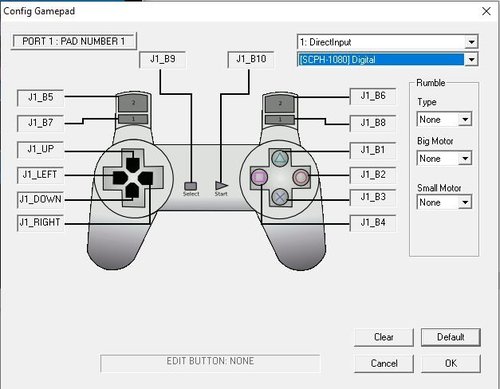

Yes I followed your mini tutorial to get this far.  So you are saying that I should get my PlayStation controller to work first in ePSXe.  It does work and the configuration is attached below.  All games work this way and no problems found.  However when I launch the game in Hyperspin (emulator ePSXe) the controller is unresponsive for the game 2Xtreme.  It does work however for game 007 world is not enough.  Seems some games work and some don't.  Not sure on the ratio but from what I have tested so far, 50/50.  The controller is a stock Sony SCPH-1080 and the USB interface is a Komodo.  Again, I did have it working once or twice with the game 2Xtreme but after I exited and went back into hyperspin, it no longer worked.

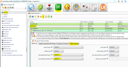

PS1 games are a mixed bag like that. Some games will only work in "Digital" others will need "Dual Analog"... some may even work with either/both.
You can specify which connection to use on a per game basis in RLUI "edit global module" --> "Rom Settings" tab:
You can find more info about it in this thread on the RL forums:
http://www.rlauncher.com/showthread.php?4408-Sony-PlayStation-Controller-Compatibility-Matrix-and-List-of-Special-Settings&p=47221#post47221
Spawk,
I may have to start calling you Google, again you have the right answer.  Setting that variable was just what I needed and now everything is working as it should Thankyou!
