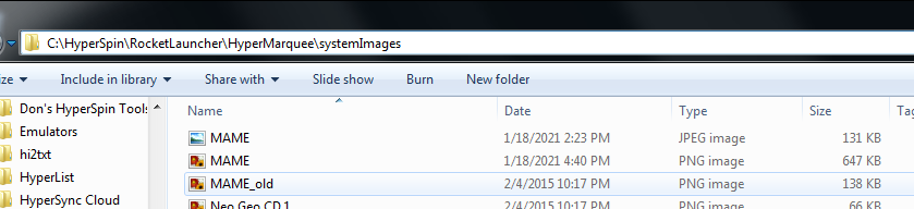

schmucm Posted January 31, 2021 Author Posted January 31, 2021 Using EDS. While my folder system is different, I think we have very similar setups. I renamed the EDS file to LEDBlinky and mapped to it from HyperHQ. The strangest part is the marquees change when scrolling through the games. It is only the system wheel that doesn't work. My system image files are MAME.png, Nintendo Entertainment System.png, Super Nintendo Entertainment System.png, and Sega Genesis.png. I could understand one of them needing to be NES.png or something like that but MAME.png should be fine at the very least. The game wheels for every system work correctly which makes me think my naming conventions are fine.

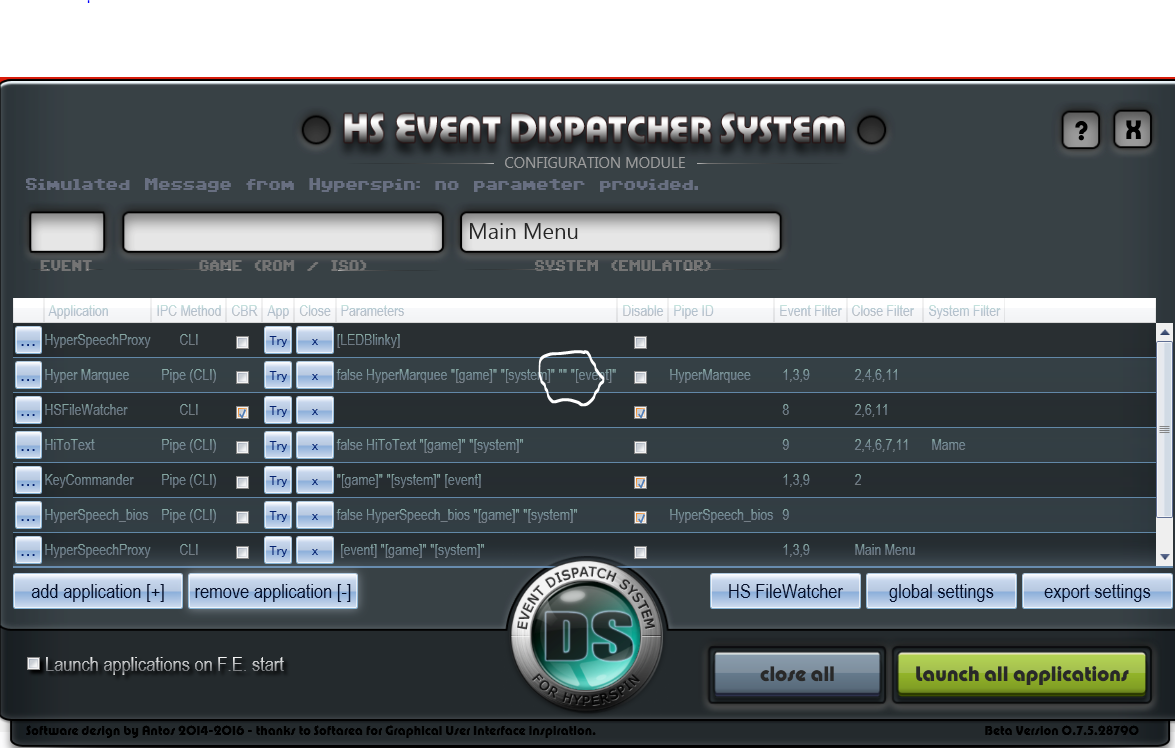

stevepel Posted February 1, 2021 Posted February 1, 2021 Try this experiment to rule HS out of the equation: Launch EDS UI Specify the following in the fields to "Send Message from Front End: Event: 1 Game: <pick any mame rom e.g. pacman> System: MAME Hit the "Try" button for HyperMarquee. This should launch HM and display the marquee for the game you specified. Now set the above fields to: Event: 7 Game: MAME System: MAME Hit the "Try" button again for HyperMarquee. This should display your MAME system marquee. You can try the same for your other systems. If your game marquees display this way but the system marquees still don't then it has to be something with the image locations and paths setup in HM.

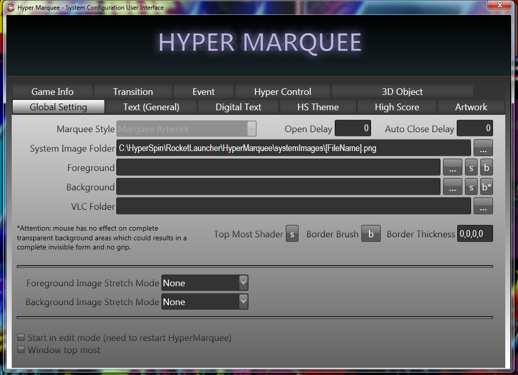

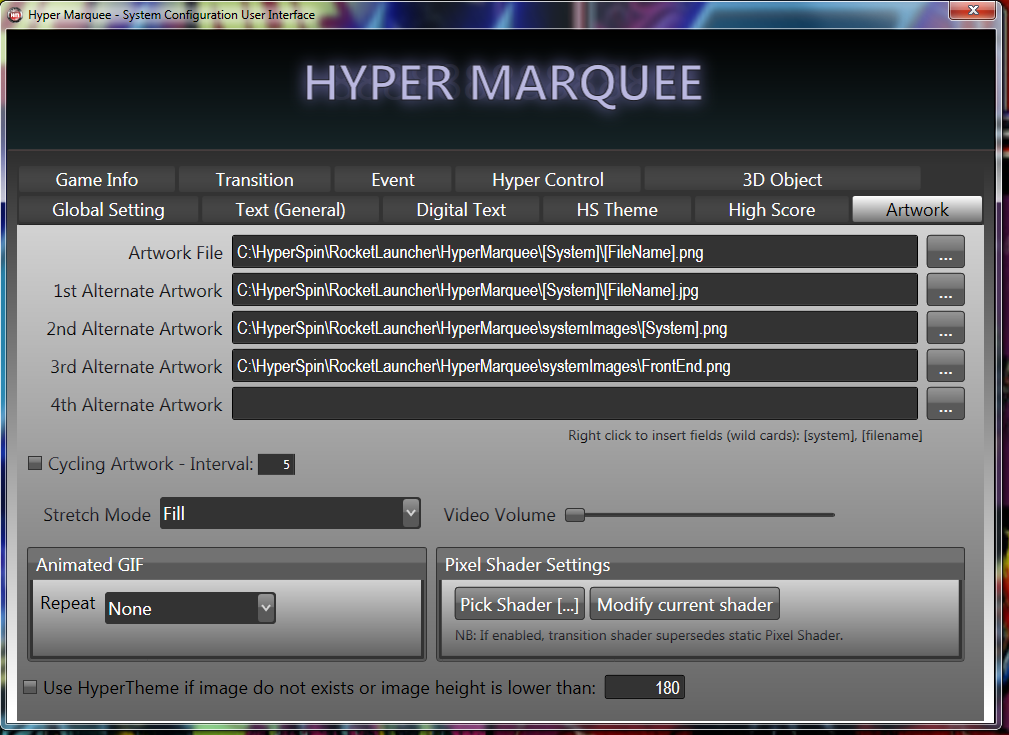

schmucm Posted February 1, 2021 Author Posted February 1, 2021 Thanks for that. I had no idea how to use EDS to test the system selection. Sending the rom information worked fine. Sending the system name (Event 7, MAME, MAME) just gave a black screen. So it looks like the issue is with HM. I guess that narrows it down. What's interesting is if I put the system location as a backup artwork, then it will display. So the file path is good. HM can display it as artwork for a rom; just not as a system. UGH! I feel like it's something stupidly obvious. Here is the HM location and then the file locations.
stevepel Posted February 1, 2021 Posted February 1, 2021 I think I see your problem. Refer back to my first response. To get this to work, I needed to have the location for my system images as the first Artwork File path on the Artwork tab. I don't recall how I stumbled upon this solution and come to think of it not sure if the setting on the Global Settings tab makes any difference. My 1st alternate path is for the game marquees (all are .png format so I didn't need another alternate for .jpg). My 2nd alternate path is for the default image if neither of the above can be displayed.
schmucm Posted February 2, 2021 Author Posted February 2, 2021 That is an amazingly clever workaround. I now have the Artwork image be the system and then 1st alternative be the rom. It now works when I do your EDS test. I can pass Event 7, Game MAME, System MAME and HM responds correctly. Of course, HS still does not. Recall any odd settings in HS that needed to be set to get the system to trigger?

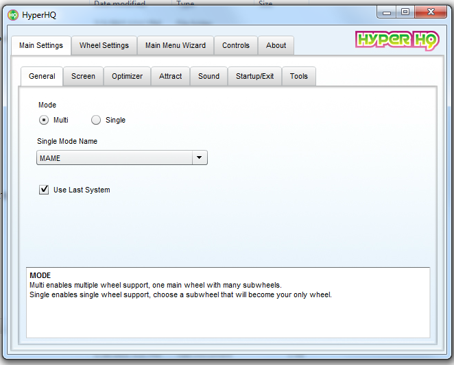

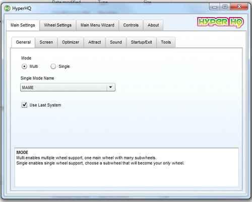

stevepel Posted February 2, 2021 Posted February 2, 2021 Progress! I don't think I had to do anything special in HS. Not sure if it matters but I'm running in Multi wheel mode.

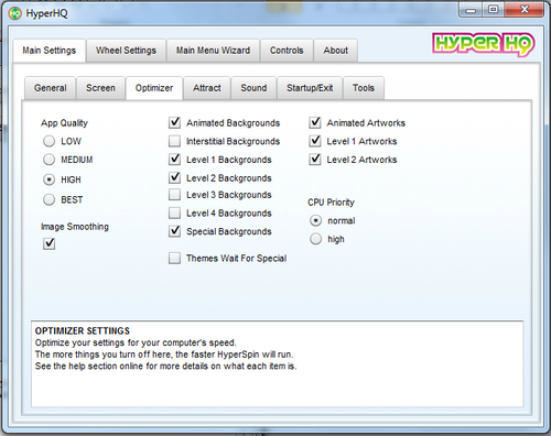

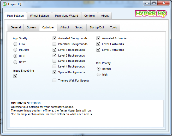

schmucm Posted February 2, 2021 Author Posted February 2, 2021 Multi Wheel mode makes sense. I'm doing the same. My settings are here but I'm not seeing anything that could really impact how it calls EDS. I didn't touch the screen tab. Optimizer is below. Attract is disabled. Didn't touch sound. Startup/Exit is normal with the intro videos enabled. For Tools, LEDBlinky is enabled and the EDS file is selected. I also have the High Score enabled. So strange that so much works except the system wheel. Definitely appreciate your help. I've been trying for months. This is definitely the closest I got. I also have some additional process monitoring tools to try and catch what exactly crashes EDS (going back to our other thread).
stevepel Posted February 2, 2021 Posted February 2, 2021 Unfortunately I'm at a loss at this point. The only differences I see between our HS setups is I have CPU priority set to High and High Score disabled. Also I'm running the earlier version.

gigapig Posted February 3, 2021 Posted February 3, 2021 Yours <ArtworkPathLocation>C:\HyperSpin\Media\Main Menu\Images\Wheel\[FileName].png</ArtworkPathLocation> <Artwork1AlternativeLocation>C:\HyperSpin\RocketLauncher\HyperMarquee\[System]\[FileName].png</Artwork1AlternativeLocation> <Artwork2AlternativeLocation>C:\HyperSpin\RocketLauncher\HyperMarquee\[System]\[FileName].jpg</Artwork2AlternativeLocation> <Artwork3AlternativeLocation>C:\HyperSpin\RocketLauncher\HyperMarquee\systemImages\[System].png</Artwork3AlternativeLocation> <Artwork4AlternativeLocation>C:\HyperSpin\RocketLauncher\HyperMarquee\systemImages\FrontEnd.png</Artwork4AlternativeLocation> Mine <ArtworkPathLocation>C:\HyperSpin\RocketLauncher\Media\Marquees\[System]\[FileName].jpg</ArtworkPathLocation> <Artwork1AlternativeLocation>C:\HyperSpin\Media\[System]\Images\Wheel\[FileName].png</Artwork1AlternativeLocation> <Artwork2AlternativeLocation>C:\HyperSpin\RocketLauncher\Media\NES\Marquees\[FileName].jpg</Artwork2AlternativeLocation> My HM looks for marquee images in RL first and then if it doesn't find any then it looks in the HS media folder. There is a slight difference in the highlighted lines above as well a few other things in the xml which mine has blank. I have attached it for you to compare. There's also a set of quotes missing from your EDS which may be nothing and its been so long I have no idea why they are there on mine. HyperMarquee.xml
schmucm Posted February 4, 2021 Author Posted February 4, 2021 Thanks for the .xml. I did compare it and removed some of my entries. They are now more aligned. Ran it and same result: only the games change. I then added the extra quotes that I did not have. No change in functionality. I was expecting that to either fix or break it. I should add that from EDS, if I 'Try' it with any number and "MAME" for the game and "MAME" for the system, HM comes up correctly. It also comes up correctly using "Unknown" and "MAME". It's only when scrolling through HS that there are no changes. So bizarre. Oh well! Definitely appreciate the helpful attempts.
