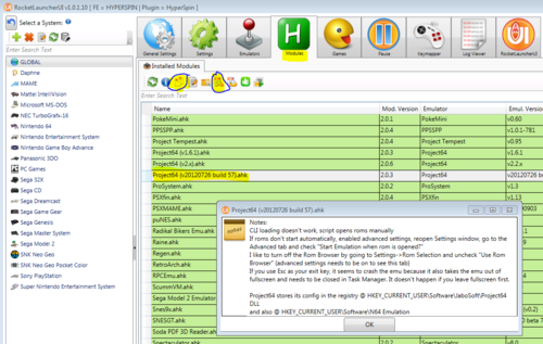

There is two places you should always look when setting up any system. That is the "Module Notes" and the "Edit global module settings" buttons:
Thanks Spawk!  That did it.  I updated my system to Windows 10 and blew away my HS install at the same time.  Rebuilding and having to remember/relearn everything.  Glad there are peeps like you in this community.
