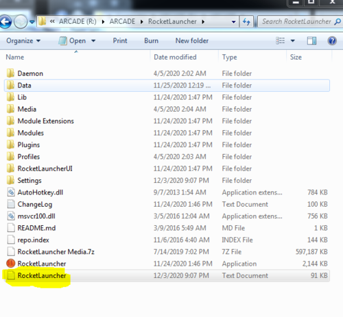

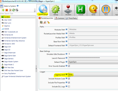

Spawk Posted April 2, 2021 Posted April 2, 2021 In RLUI set the logging level to "troubleshooting": Then try to run a game one time. It will create a log here: Take the actual log (do not copy from inside RLUI or notepad) and upload it to pastebin.com It will create a link and you can share the link here. ** turn off troubleshooting when finished as it will slow down loading in general.

Spawk Posted April 2, 2021 Posted April 2, 2021 Logging is usually set to “Error” by default. You need to change it to “Troubleshooting”. Also there is usually no need to rename the log, it is re-generated every single time you launch a game. So it always only contains info from the very last launch you made.As for pastebin, you just drag the rocketlauncher.txt file over... nothing to do with any ahk.I am at work now and on my phone so I am not sure I can access that link. I will have a look later when I get home.Sent from my iPhone using Tapatalk
