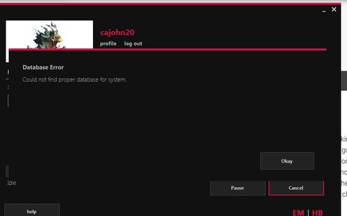

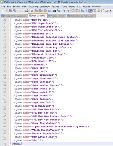

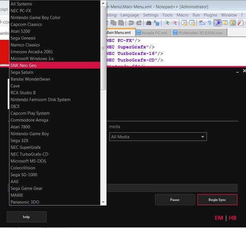

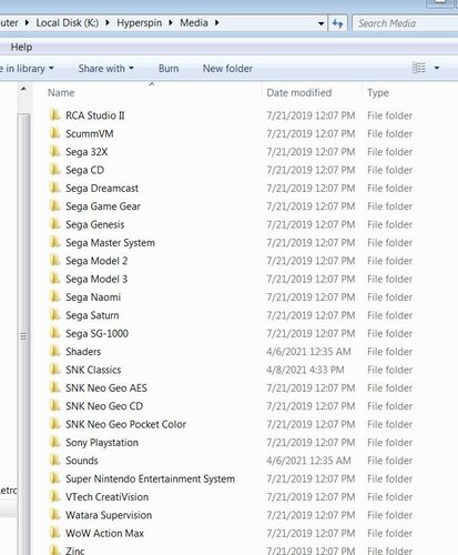

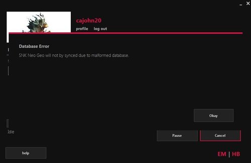

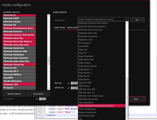

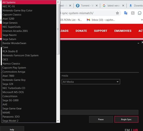

Ive been having this issue where the systems linked and read from the media configuration does not match what is in the sync section when looking through the systems that can be selected. I have a oddity where "SNK Neo Geo" is in the sync list but not in the list of systems in the media configuration of hypesync. At one point I did have "SNK Neo Geo" listed in my hyperspin as a system in the Main Menu.xml but I removed it and its media folder from the media directory of hyperspin. I double and triple check but I can not fiigure out why "SNK Neo Geo" is still listed under the sync system section of hypersync but not listed under the media configuration sysem section as expected. It throws an error when i try to batch sync all systems when it encounters it as it goes through the list. Kinda of irriattating  having to watch it and then continue after error is thrown. I would prefer to fix this as in having "SNK Neo Geo"  removed from list. Its almost like it not updating the actual list of systems corectly from hyperspin unless I clearly missed something of just over looking an area.  I will include screen shots of what I explain.

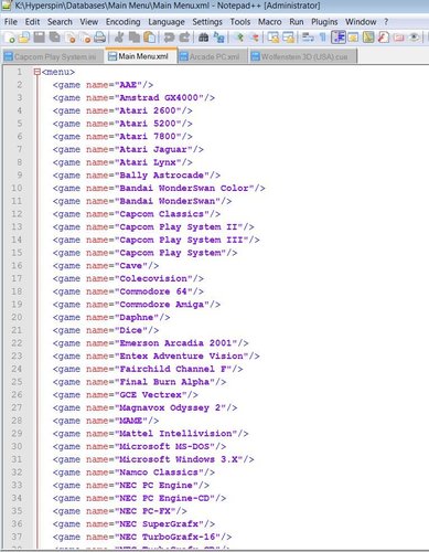

So if a system isn't listed in the Main Menu.XML and the Media Configuration in hypersync references list from ( I assume my hyperspin Main Menu.XML) would there be any reason why the system list under the drop down of the sync section of Hypersync be different? Does the sync section of hypersync use something else that is not listed in the Main Menu.XML? Any help would beappreciated.

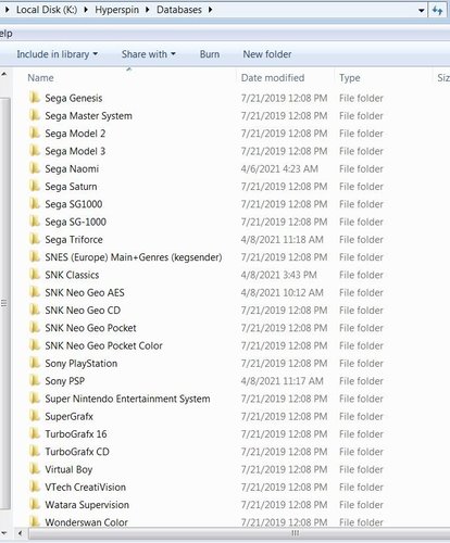

I doubt the main menu xml has a lot to do with sync... but rather the xml with the actual list of games it wants to match. In your case I am assuming the SNK xml. Having one there even if you are not using it in your system shouldn't really be a problem unless possibly you were editing it by hand. A simple formatting error can ruin an xml. Try deleting the SNK database altogether or download a fresh one.

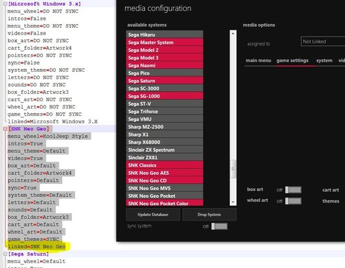

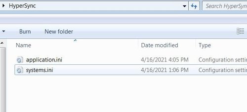

Within reason I came to conclsion I mustve done some wrong or didnt drop the snk neo geo system way back when and it was still listed as a available system and caused a mistmatch. I located ini files where hypersync stores settings. Within the settings ini file, all systems I had setup were listed. The odd ball was "SNK Neo Geo", which I had no use for since nothing was linked to it via my setup (Sanity checked and went through all systems and verified nothing was inadvertantly linked some how). "SNK Neo Geo" show it was linkd to "linked=SNK Neo Geo". I just removed the system from the systems ini file. Problem solve. Restarted Hypersync and everything worked as expected. Annoying this happened but I it helped me recalls some things I had forgotten.
