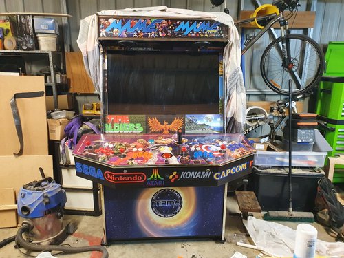

I just completed building a 4 player standup arcade machine with a 43" 4K monitor using all Ultimarc parts.  I have configured the machine so each player has 8 buttons, a coin button and player button with this all feeding into an Ultimarc IPAC 4 controller (maxes out the inputs for this board).  I also have the Ultimarc trackball set up as a mouse with two mouse buttons.  I have attached a picture.
I originally was planning only to run MAME so didn't add any extra buttons as I don't like the extra clutter and I normally use a wireless keyboard and mouse.
