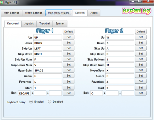

ZCore13 Posted April 22, 2021 Author Posted April 22, 2021 Thank you for the reply. The start key is the number 1 in all three programs. I've attached the setting page from HyperHQ.
Spawk Posted April 22, 2021 Posted April 22, 2021 1 on keyboard should launch then... make sure HS is the window in "focus", should be exactly same as in RL.
ZCore13 Posted April 22, 2021 Author Posted April 22, 2021 It's definitely in focus because I'm selecting Mame from the wheel using the joystick and the start button and/or the number 1 to select it. I then can scroll through all the hundreds of working MAME games with the joystick, but nothing will start a game through HyperSpin. I've tried pressing every key on the keyboard. Other keys can scroll, choose genre, favorites, etc. Nothing starts a game.
