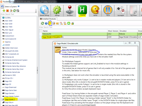

Hello everyone, I discover hyperspin and rocketlaucnher and I need your help.
When supermodel starts, it is not displayed in full screen but remains in the windows taskbar. I have however set true in rocketlauncher in fullscreen specifically for supermodel and I have also tried to make the supermodel ini file read only by specify fullscreen = 1. if I do not go through rocket launcher but directly with surpermodel everything works perfectly. I did not find an answer on the rocket forum because the posts are at least 5 years old ditto with youtube. Can someone help me?
Thank you to everyone who will take the time to read my message.
Whenever setting up any system, it's always best to read the module notes:
Any little quirks like this are usually mentioned in these notes.
