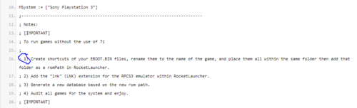

Spawk Posted June 14, 2021 Posted June 14, 2021 That's not really the "proper" way to launch. Is there a reason why you are not using the rcps3 module and following the notes? The PC launcher module usually requires you to set an "appwait.exe" so it knows what window the actual game is... and/or possibly a "fade title" if the emulator has more than 1 window. The rcps3 module states that "Qt5QWindowIcon" is the "primaryWindowClassName" so you could try that here:

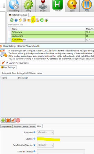

megananthony Posted June 14, 2021 Author Posted June 14, 2021 Thank you for the info Spawk, i setup a folder called 'PS3 links, i right clicked the eboot.bin file in the USRDIR and named it NPEB00073 i then put that link in the folder and added the folder path in the rom location settings *i also made sure to remove my game specific setting under the module tab for the application path and post launch path tried to run in RL and it says: "have not setup NPEB00073 in RLUI yet, so PCLauncher doesnt know what exe, fad title and SteamID to watch" ( i will revisit trying to get them to work this way if you have any other clues i can follow Thing to keep in mind is that (even though it is a very long and tedious way to get the eboots to work, it still launches them fine , fullscreen, in RL. ---- I also went in and typed Qt5QWindowIcon in the fade Title screen That worked! , launched through HS fine, fullscreen..for about 30 seconds then i got a pop up saying " There was an error waiting for the window Qt5QWindowIcon, please check if you have the correct version emulator installed, followed any notes in the module, and have this emulator working outside your front end first. Also turn off Fade to see if you are hiding your problem SO SO CLOSE!! maybe it has something to appwait, happen to be able to provide any more details on how i would go about setting up appwait.exe? (or on anything else i mentioned above)? I look forward to hearing back
Spawk Posted June 14, 2021 Posted June 14, 2021 I hope you are not renaming the actual eboot.bin's, and only renaming the shortcuts (.LNK) you created from them. You can also use real game names, not the sony codes. I don't see any reason why it wouldn't work through the PC launcher module as well though. The waiting for Qt5QWindowIcon message leads me to think it may have been changed in a newer version of the emulator. There are a few ways you can find out the windowclass name. I use a freeware program called WinLister 1.22. Just run a game through the emulator and alt-tab to WinLister to see the name.
Spawk Posted June 14, 2021 Posted June 14, 2021 3 hours ago, megananthony said: tried to run in RL and it says: "have not setup NPEB00073 in RLUI yet, so PCLauncher doesnt know what exe, fad title and SteamID to watch" Also, this first method should use the rcps3 module, not the pc launcher module.
