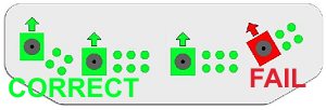

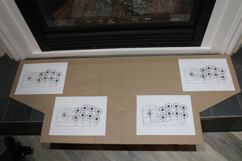

Dubbloseven Posted August 15, 2021 Posted August 15, 2021 Finally working on a build after messing with arcade and emulation over 20 years quick question or any feedback appreciated. I'm doing a 4 player pedestal build. How should player's 3 & 4 joysticks be oriented ?? Is the graphic below accurate?? Right or wrong ?? does it matter that much? Does anyone who has done builds have some feedback on this. Thanks in advance. Will post a picture of the prototype from cardboard I cut out of the control panel shape and size I'm going to use. The following picture is a graphic depicting the "right" or "wrong" angles that I've seen floating around arcade forums for many years. Thoughts? Advice ? Gamer's who have done previous builds?? All and any feedback welcome. My YouTube Channel https://www.youtube.com/channel/UCx0yXVItMU6uz4z5hUavGgA

gigapig Posted August 19, 2021 Posted August 19, 2021 I'm sure it would be fine as it is and I don't think there are that many 4 player games, but for comfort I feel 3 & 4 should be at 45 degrees (clockwise 3, anticlockwise 4.) Kind of like Gauntlet.
Dubbloseven Posted August 20, 2021 Author Posted August 20, 2021 Thanks for the feedback Giga. Hope you are well I saw a few youtube video's since this post, from people who reviewed their own builds; One who reviewed their extreme home arcade build (extensively I might add). They actually did gripe about the 45 degree or angled controller not feeling correct despite the Gauntlet layout ( Which is a legendary game btw; I did play in the Arcade when it was released. Bought it on NES when it was released as well) One review on the Megacade on youtube, he actually uses Gauntlet as an example how it feels incorrect on his 4 player Megacade Layout. I think im gonna lay them out somewhat sqaured to the others and the screen after seeing some reviews. Still considering so i do appreciate the feedback and discussion. Any & all suggestion's are still welcomed for discussion here. Thanks all have a great day & have fun gaming. My YouTube Channel https://www.youtube.com/channel/UCx0yXVItMU6uz4z5hUavGgA
gigapig Posted August 20, 2021 Posted August 20, 2021 My concern would be the outer players just being in the way of players one and two. But if there's enough space then it would be the best way to go. Either way a nice problem to solve, I'd love to build another. Good luck with it and keep us posted.

BillyGoatfeet Posted January 17, 2022 Posted January 17, 2022 A lot of people say to stick to the Konami 4 player control panel spacing, re: The Simpsons. I think your indents for player 3 and 4 will cause issues as well. Better to have the front edge be uniform as seen in The Simpsons. That design is arcade proven and it quite functional. Either way good luck with your build. You will have fun with it regardless and that is all that matters.
