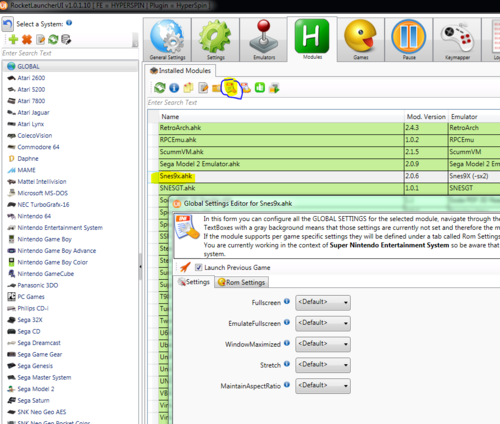

1. J'ai installé l'émulateur Snes9x je l'ai paramétré en fullscreen au lancement des jeux mais lorsque je le lance avec HS il démarre en mode fenêtré ?!

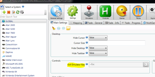

2. Pareil pour la touche " exit " je l'ai indiqué dans HyperHQ (touche ESC) mais rien n'y fait au lancement de Snes9x impossible de sortir de l'émulateur avec cette touche je dois combiner ALT + F4 ?!

1. Most of the time you have to tell RocketLauncher what you want even if already set in the emulator itself. You can do this by clicking the "Edit Global Module Settings" button:
2. Exit is also handled by RocketLauncher. It is set to "Escape" by default but this can cause issues with emulators that assign "Escape" to a different function. If you can change the function to something else in SNES9x then I would do that. If not, you can change the exit key in RL just for that system... or possibly all systems? Some people prefer not to use escape but I have always used it fine.
