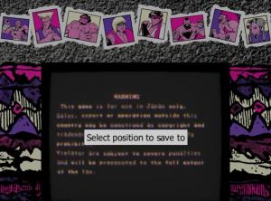

2) Save states... when select savestate in hyperpause it sometimes work and sometimes not... and when it works i see this:
and i have to press a key in the keytboard for it to save the state... it looks like it save the state in that key (1,2,3,Q,E,etc) i mean not just the number like in most emulators.
SOmeone knows if it should work like this?
[ATTACH=CONFIG]42206[/ATTACH]

I do use hp to save and load... When returning from hp, after select save or load I got this screen... Maybe my save keys in HLHQ are wrong... How yours look like?
