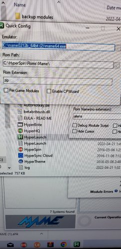

In HyperLaunch, system name/Emulator was originally set to 0.212b which reads 22 out of 33 in Hyperspin
I have tried the other 2 versions which only launches a few games and the other emulator launches 1 game (mutan ninja turtles in time) in HS. Im suprised that the newer versions barely works with the roms I have.

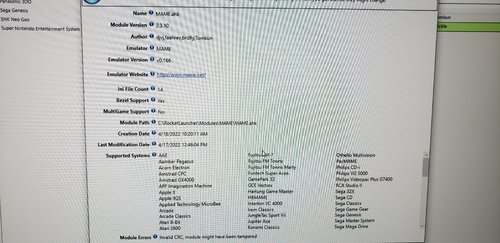

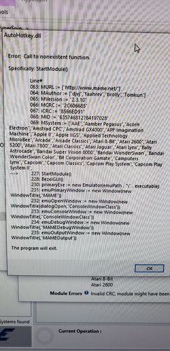

- The other thing is , RocketLauncher newest version comes with a bad .ahk modules for mame. It wont work with anygames. Somehow, Still show green in rocketlauncher/modules . I have download the mame 212 .ahk modules and replaced the old one. Now show red with a invalid CrC but makes 22 of my games work out of 33

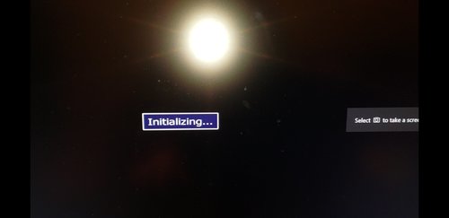

Unfortunately, I cannot find the issue. Today, I have tried to replace the game with a different version which cause the exact same problem.
The game tries to launch. But instantly comes back to HS. Very quickly, A screen "initializing" appears for .5 seconds.

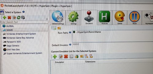

 Rocketlauncher is set to read the roms from folder Hyperspin/roms/mame. Somehow if the roms aren't located into the folder of mame/roms. It wont read in hyperspin. I moved all my roms from HS folder rom into Mame folder rom and it works now. I still dont understand why though.. on the screenshot below, It clearly shows the rom path in emulator tab : Hyperspin/Roms/mame in RL
