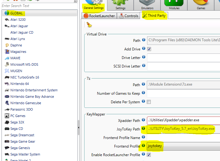

Hi Spawk,
The only Joy To Key path I could find was on this page. Also I have two menus on the left, one for Global and one for MAME. These have different settings on some areas. Should I be using two or one?
Also noticed if I CTRLALTDEL there are two instances running once I go into a game, one Hyperspin the other MAME. Hyperspin has sound, MAME doesnt. When I return to menu, it only shows the Hyperspin instance.
I've taken screenshots of several other areas in hope I can get you to take a look for any other reason that could be causing JTK to bail out.

Hi Spawk,
No luck unfortunately. I did as you said but it made no change. I then tried changing the path as I have a standard and an _en folder and got an error. Now it won't open a game in HS (wheel still goes up and down using stick) nothing happens when I hit the action button that used to start a game (the error hasnt come back since the first time I launched a game)
Tried putting back to how I had it but same thing doesnt start a game anymore.
I checked in JTK and the 'Start' button is still mapped highlighting, so I am more thinking this isnt a JTK issue, its more its not launching the MAME emulator now?
I have a few joytokey folders not sure why:-
D:/Hyperspin/Arcade/Joytokey/joytokey.exe (this was what it was on)
D:/Hyperspin/Arcade/Joytokey_en/joytokey.exe
D:/Hyperspin/Utilities/Joytokey/joytokey.exe
D:/Hyperspin/Utilities/Joytokey_en/joytokey.exe (this is what I tried changing the JTK path in RL to then got the error and no longer opens a game)
Anyway I could pay for your time to remote onto my box to take a look yourself? Nothing on there other than my HS setup.
No description available.
