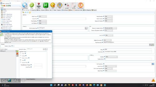

Creezz67 Posted August 25, 2022 Posted August 25, 2022 Hi all, Trying to change over from XBOX 360 to XBOX One controller and everything working EXCEPT the global exit setting in RocketLauncher. Works perfectly fine with XBOX 360, but not working when using XBOX One Controller. Has anyone managed to get this working or am I just wasting my time ? Any help appreciated.

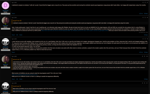

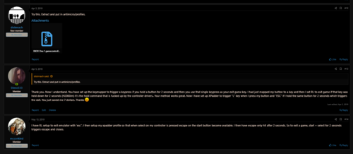

Dime333 Posted August 26, 2022 Posted August 26, 2022 There are ways around this issue. https://www.rlauncher.com/forum/index.php?threads/using-xbox-controllers-please-read.6041/

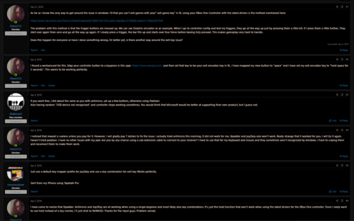

Dime333 Posted August 27, 2022 Posted August 27, 2022 Took some screenshots of the discussion. Shortly after the discussion I switched to using ReWASD. It works great and you can also map the XBOX button which you can't do in most other mapping software. Hope this helps.
Creezz67 Posted August 28, 2022 Author Posted August 28, 2022 17 hours ago, Dime333 said: Took some screenshots of the discussion. Shortly after the discussion I switched to using ReWASD. It works great and you can also map the XBOX button which you can't do in most other mapping software. Hope this helps. Thanks for this. Can it be added to RocketLauncher or do you just use it on it's own ?
Creezz67 Posted August 29, 2022 Author Posted August 29, 2022 18 hours ago, Dime333 said: I just start it with windows. Yeah, I thought as much. Thanks for your help with RL info. I think I will stick with XBOX 360 controller. Can't believe nobody has found a workaround after all these years for just a simple button hold (global exit) issue, as everything else works fine.
