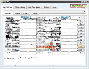

damageinc86 Posted July 4, 2014 Author Posted July 4, 2014 and now my hyperspin doesn't even start up anymore lol. All to try to get epsxe working with hyperlaunch. Finally got it working, then tried to go into hyperspin to check my wheel out and bam. now nothing.
rfancella Posted July 4, 2014 Posted July 4, 2014 damageinc86 said: and now my hyperspin doesn't even start up anymore lol. All to try to get epsxe working with hyperlaunch. Finally got it working, then tried to go into hyperspin to check my wheel out and bam. now nothing. You might try downloading the newest HyperSpin update from the downloads section and extract it over your existing setup. http://www.hyperspin-fe.com/forum/downloads.php?do=file&id=5692 If that doesn't work, maybe grab the full release. http://www.hyperspin-fe.com/forum/downloads.php?do=file&id=5689 Do not overwrite your existing setup, be sure and backup your .../HyperSpin/Settings and .../HyperSpin/Databases folders. Then extract the full release over yours and restore your Databases and settings. This is a last ditch option. You can easily mess up your setup even worse, but it might be worth a try. Thanks, Ron Code Monkey and all around Command Line geek!If you like what someone has said or done for you, be sure and 'Thank' them. And if they changed your life, send them a Beer!
damageinc86 Posted July 4, 2014 Author Posted July 4, 2014 I did a system restore point to before I installed Git, and now I'm back in business. hyperspin launches again, and hyperhq works again.
