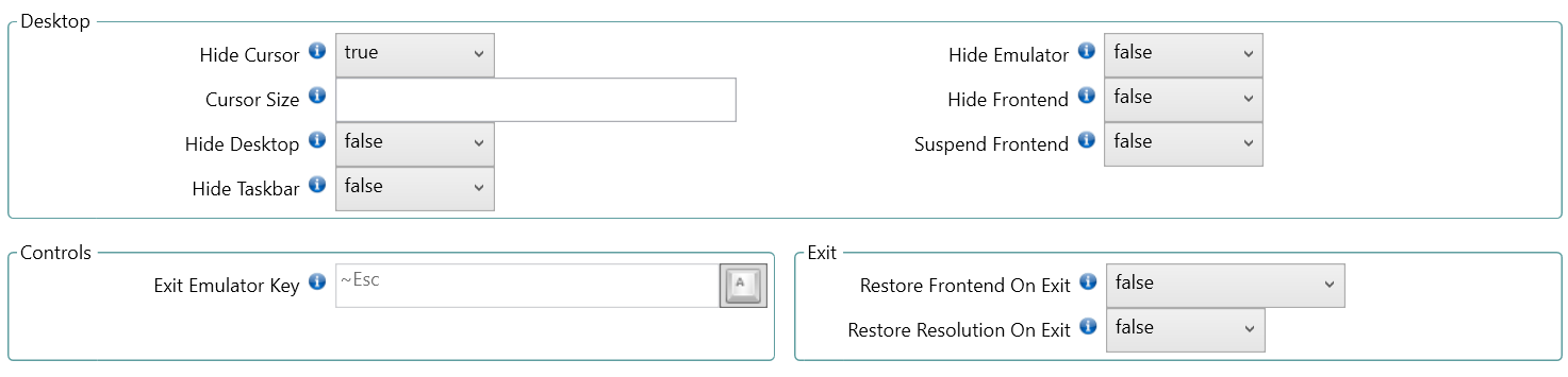

Have you tried adjusting RL - Main Setting - Exit settings:
Restore front end on exit
Restore resolution on exit
I suggest trying a different Video driver in RA to see if the behavior changes.

I assume this is because of your Global/Main Settings/Desktop and Exit settings
These are my settings (I don't know what's "best" only that they work with HS/RL/RA):
