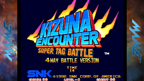

Agard Posted March 7, 2024 Posted March 7, 2024 Hi HyperSpinners i'm trying to run Kizuna Encounter - Super Tag Battle [4-Way Battle Version] but it uses the rom kizuna even though there's a rom name kizuna4p if I use rom name kizuna4p it says can't find rom kizuna4p how do I get HyperSpin & RocketLancher to run this game. Thanks
floatingyeti Posted March 7, 2024 Posted March 7, 2024 I added the game using the kizua4p (non-merged) rom and it launched normally. Maybe using the non-merged version will fix the issue?
Agard Posted March 8, 2024 Author Posted March 8, 2024 Thanks i'm using split roms but MAME uses kizuna rom now to launch kizuna4p. I always though split sets made clrmamepro show all roms but it doesn't non-merged did the trick though made the size go up a bit altogether. Thanks floatingyeti Clrmamepro now shows i'm missing all these samples although the size is 0 how do I make clrmamepro show as all files found? https://postimg.cc/cgXMSCFr
