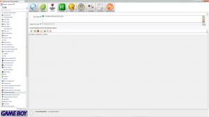

I'm trying to get all 3 Gameboy's to run in Hyperlaunch but it just gives error Can't find T:\Emulators\Vbam.ini, got everything set up outside with VisualBoyAdvance-M, It looks for it in the wrong Dir.
Vbam.ini is in the Emulator folder.
I would appreciate any Help Thank you.

This is wrong and that's what's causing the problem:
emuFullPath = T:\Emulators\VisualBoyAdvance-M
emuPath = T:\Emulators
Are you editing your ini files manually instead of doing it through HLHQ? Definitely seems so as HLHQ won't let you set your emulator path to a folder. Just correct your emulator path in HLHQ and everything will work.
Sorry had this in the wrong section before.
So far so good. Only please set your Logging level to Troubleshooting. Try to run a game and post your log again.
Did you run VisualBoyAdvanced-M.exe first, to create the vbam.ini file??
Thanks,
Ron
Sorry Brolly for got to take Emulator back out when I was testing.
I took it out and its still the same as the other 2 Gameboy's, Here's the Log

Have no idea what you mean by the "old way" you still have the exact same problem you're pointing the emulator path to a folder. You are editing the files manually right? Never do that.
Fix the path on HLHQ, if you think you did that already and it's not working post a screenshot of your VBA-M emulator config in HLHQ, it should be glowing red clearly showing you have a problem and things won't run.
Here's the VBAM.ini from the Emulator. In HLHQ there's nothing red and the dir are set proper. when I start the emulator outside of HLHQ it start fine but in HLHQ it says cant find T:\Emulator\Vbam.ini but my emulator is in T:\Emulators\VisualBoyAdvance-M.
I seriously haven't changed it manually.

Like I said, your emulator path is wrong it cannot be pointing to a folder. The VBA-M.ini file has nothing to do with the problem you are getting so no need to post it.
I need a screenshot of HLHQ showing your VBA-M emulator configuration.
No, I need to see the Emulators tab under GLOBAL showing VisualBoyAdvance-M. While at it also double click on it and post a screenshot of that window as well.
I figured out what it was. The exe was missing from when I chose the Dir for some reason it didn't select it. it showed it going to the Dir but didnt grab the exe. Thank you for your time Brolly I do appreciate it.
