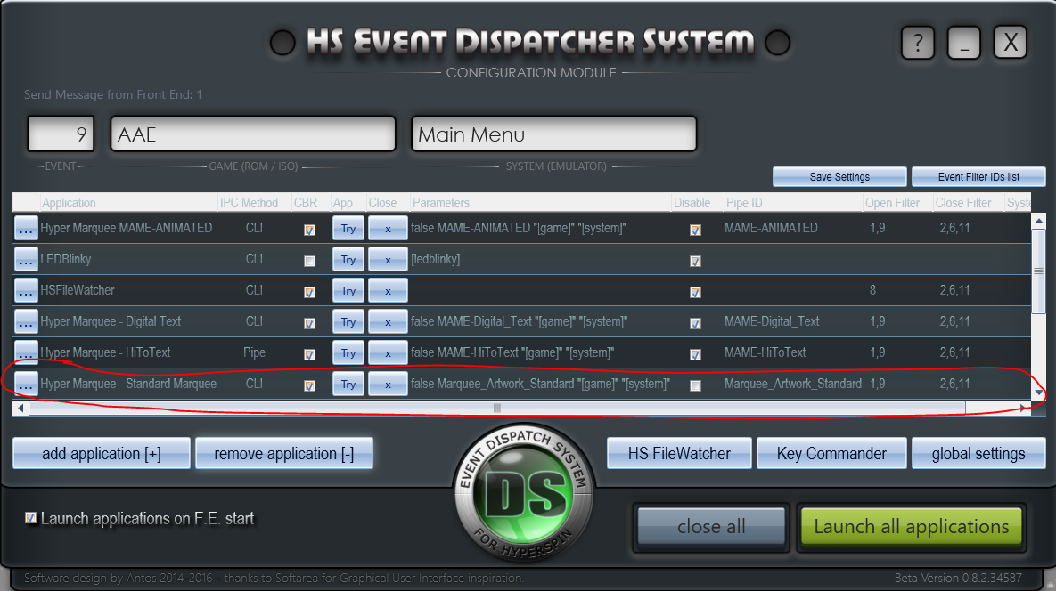

These are my EDS Settings.  Hopefully this helps.
HYPERSPIN
*Settings.ini
[LEDBlinky]
Active=true
Path=Z:\Hyperspin\EDS\

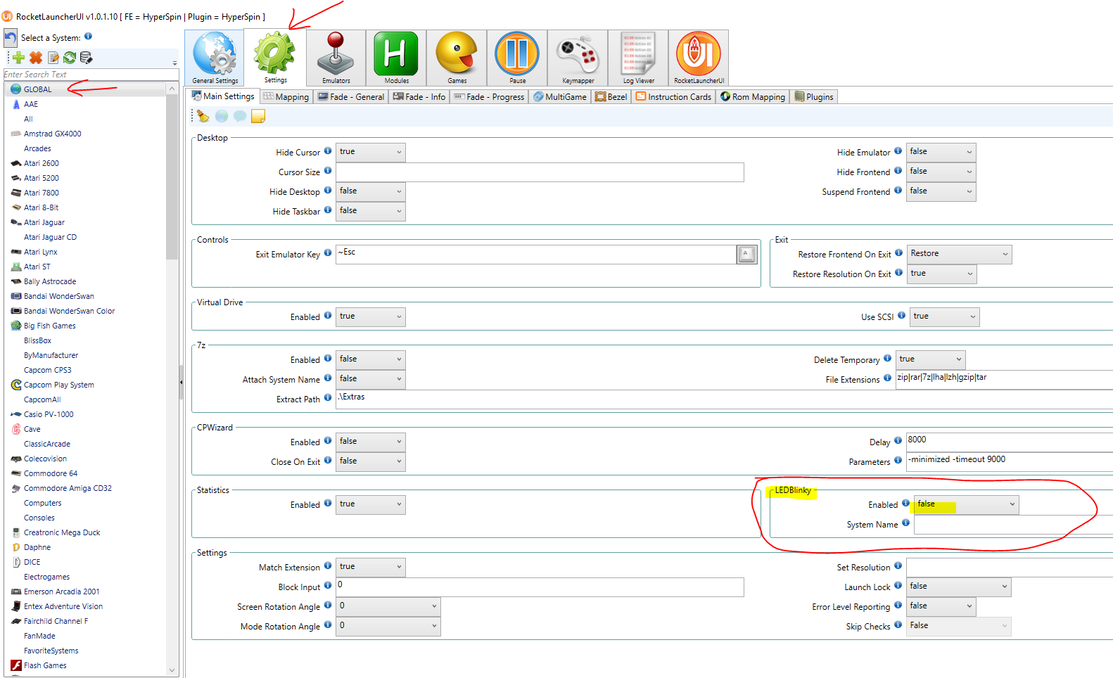

ROCKETLAUNCHER
That’s for taking your time to send this. I’ve checked and the setting look the same (within reason) however I have foind that if I create a new marquee set, it works and HS doesn’t freeze. However, it still loads the old overlay so I need to kill that first. Just trying to work out how to disable that marquee set as even when I set a new one as details. When i restart the arcade it returns.

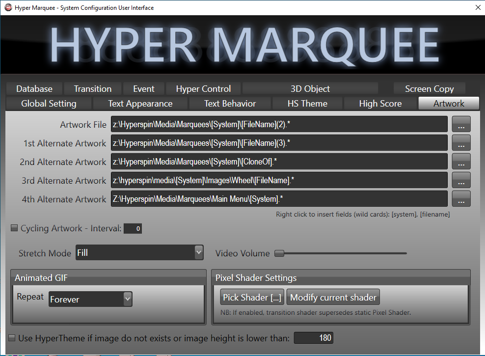

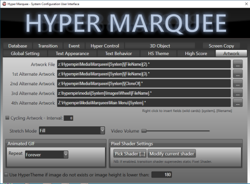

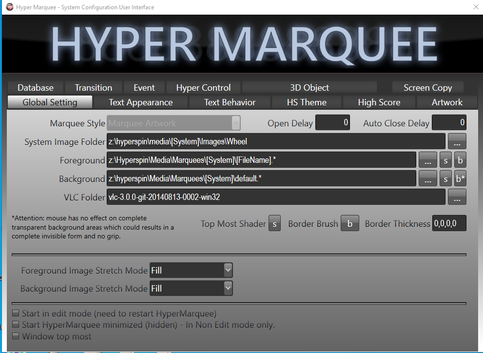

These are my settings in HyperMarquee.
Global Setting:
Foreground:  I believe this is the Marquee that will show on top.
Artwork:  I place all alternate artwork here.
