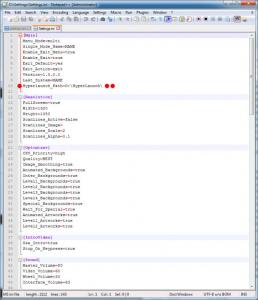

gigapig Posted July 19, 2014 Posted July 19, 2014 Hi dmanc, welcome to the forum. You need to the Hyperspin settings.ini, you can find it in the Hyperspin> settings folder. Look for path to Hyperlaunch and change it to match your setup and include a backspace at the end.

dmanc30 Posted July 19, 2014 Author Posted July 19, 2014 Gigapig, I just figured it out. I created a folder on my desktop and put Hyperspin files there, so I created a Hyperspin folder in my C: drive and moved all the files to that folder to match what was in the Settings.ini file and that did the trick, but you get full credit for pointing me in the right direction. Thank you again
gigapig Posted July 19, 2014 Posted July 19, 2014 Your quite welcome. Just so you know for next time, here's what I meant. This is the Settings.ini file in the location :\Hyperspin\Settings You just change line 10 to point to the location of Hyperlaunch folder.
