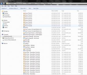

lojac005 Posted July 26, 2014 Author Posted July 26, 2014 Thanks again Ron... this is MORE than helpful !!! I will definitely get HyperTools. Here's a screen shot...
rfancella Posted July 26, 2014 Posted July 26, 2014 Thanks again Ron... this is MORE than helpful !!! I will definitely get HyperTools. Here's a screen shot... [ATTACH=CONFIG]42871[/ATTACH] Yes, Looks like you need to just use the cue extension in your list generation. Hope that helps. Thanks, Ron Code Monkey and all around Command Line geek!If you like what someone has said or done for you, be sure and 'Thank' them. And if they changed your life, send them a Beer!

32assassin Posted July 27, 2014 Posted July 27, 2014 judging from your pictures you are better of renaming your cue files. Everything else can stay the same. 1. downloaded a PSX art pack. 2. copy (from the art pack) and past a matching "Game tittle" to your CUE file. YOU DO NOT NEED TO RENAME ANYTHING ELSE!!!!!! 3. Hyperlaunch will look for your Game Tittle.CUE file, mount it on a virtual drrive and load your game. if you decide to keep your current Game tittles, you will have to rename your matching wheels, videos, CD scans and boxes. you either rename: (#of games you have) CUE files or rename (#of games you have)wheels + (#of games you have)videos + (#of games you have)CD scans + (#of games you have)boxes. and I'm not counting any of the hyperlaunch Media you might wan't to add keeping your custom names will make you rename X4 more files.
