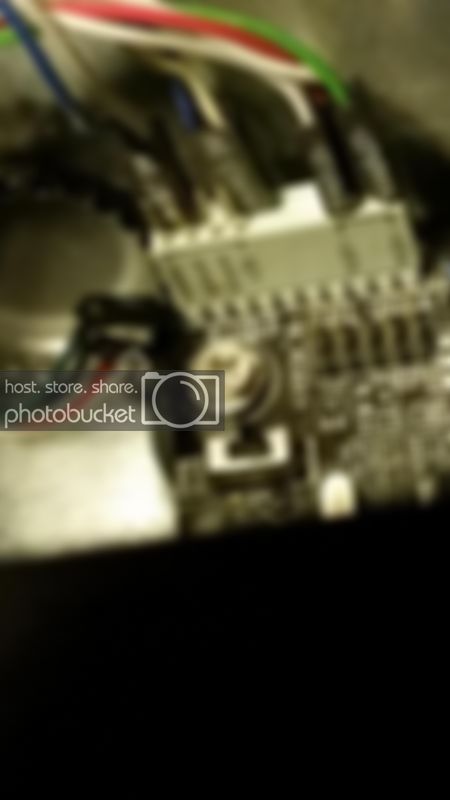

t-maxxracer32 Posted July 24, 2014 Posted July 24, 2014 Hey all, Heres my current setup so you can understand what Im working with. -8 socket power strip with an extended switch (opened the strip up, added extra wiring to route the switch so it can be accessed on the outside of the cabinet) -everything is connected to this except the TV... so I turn it on and it powers up the tv, speakers, and the marquee -computer needs to be manually turned on by pressing its power button -its located inside my cabinet so its a pain to access and shut off SO to the point of this thread I bought one of those master/slave power strips and I wanted to wire the current switch up to my computer so I press the button, it turns the computer on and then turns everything else on that is connected to the slave portion. I opened up my computer to find the power switch is a simple 2 wire setup so i cut them and wired them up to the 2 wire switch located on my cabinet. once I did this and pressed the switch the computer would turn on for a few seconds then power off. I reversed the polarity but it did the same thing Making sure I didnt screw anything up I wired up the old computer switch and everything worked fine..... I cant find anything stating volts/amps on the switch I am trying to use. Does this sound like the switch has too much power or is not giving enough power? I apologize for the rambling hopefully it all makes sense. Here is a picture of the setup inside my computer. Thanks for any help
