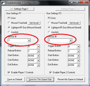

dougan78 Posted August 2, 2014 Posted August 2, 2014 No worries. If you have 1 gun working great. That is the easy part. v1 is the correct one of the emulator that works with TS2 so that is good (took me a bit to figure that out). Now. You need to pick 1 game ( I used HOTD love that game all of them are good for this emu for light gun games anyway) and start messing with which device ID as circled in the pic works. Adjust your button numbers as necessary. So set it . Keep tS2 open. open the emulator, launch game, test both guns. Repeat until you find the right IDs for your guns. It is that easy. Then go though and set each game. Do the pull down on settings 1 for each light gun game, go to settings 2 page set the IDs and bam! works. If you have a issue where you reboot your computer and the gun ids change good luck that is the bitch of lightguns. The settings are only good for the USB id the are so do not swap usb ports or something it changes what ID it is in the system. I have had this happen and need to reconfigure mame and model 2. Nestopia worked fine. those are the 3 I use with my 2 aimtraks. Good luck need anything else let me know. Cheers!

dougan78 Posted August 2, 2014 Posted August 2, 2014 I put it in a TS2_1.2 folder in the emulator folder(I assume you can just dump it into the main folder). You run it. Run the setup helper at the bottom (setupp paths etc). Then I set start,exit and coin keys for each game on settings 1. Set my devices IDs for the guns on the settings 2 (mine are 1 and 2) page and used buttons 0 and 1. Saved the settings for each game. I don't think I had much luck with save as default. My Aimtrak util: I have mouse left as trigger, and reload as mouse right on both guns. Mouse right is off screen for trigger as well. Works like a champ. TS2 does some FM (Freaking Magic) and looks for when The Model2 emu is run when a select game is run. You don't need to do anything special with hyperspin.
Jon.Damico Posted August 2, 2014 Author Posted August 2, 2014 THANK YOU! I had tried running the set-up, but it kept giving me an error on the verify location. I was copying and pasting the address of the location from the address bar (Windows XP), but it then hit me that windows XP does not add the \ at the end. So I added that, it loaded up. I messed around with a few settings and bam. It was working perfectly. All of this was because of a \ missing. This program is amazing! Thank You!
