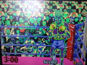

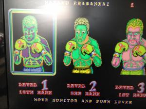

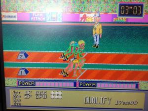

cocotse Posted August 7, 2014 Posted August 7, 2014 Hi, I'm new to all of this but I got everything running perfect except for certain roms for mame will have messed up colors. I don't know what to do please help. Thanks.

cocotse Posted August 7, 2014 Author Posted August 7, 2014 Just wanted to add that the rom runs well with the emulator but when I run it through Hyperspin the colors are distorted.
zerojay Posted August 7, 2014 Posted August 7, 2014 Can you please be specific about... well, everything? MAME build/version used, game name, etc...?
cocotse Posted August 7, 2014 Author Posted August 7, 2014 I'm running mame 32bit version 148 I haven't tried all the games but these are the ones I tried and have given me wrong colors. Simpsons arcade 88 games. I'm sure there are more. How do I post a snapshot?

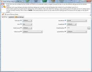

gigapig Posted August 7, 2014 Posted August 7, 2014 How do I post a snapshot? Just press print screen (Prt Scrn) A screen shot will saved to :\Hyperspin\HyperLaunch\Media\Artwork\MAME\Game Name

gigapig Posted August 8, 2014 Posted August 8, 2014 That would then suggest hyperlaunch is passing something on to mame from the settings in HLHQ? Like hlsl or maybe something else? EDIT Or video mode?

gigapig Posted August 9, 2014 Posted August 9, 2014 As your a platinum member you can grab a compiled version of mame from jumpstiles ftp folder, may I recommend the mameuifx builds. Those builds will give you nonag and hiscore support, but you may need to update your Roms if you use 0.154. You have no video card so that could be the problem or could it be that Flash is the issue here. So give some more details about your machine, Intel chipset can give issues at least with mp4 video, there is a thread dedicated to that. Have you tried a different video mode for any of those games? From the example screen shot I posted earlier you can set a video mode on a per game basis.
