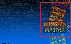

So after doing an audit, there are several version of the alot of games, I only have certain games. For instance there are 4 versions of Kung-Fu Master, yet I only have 1 version:
In Hyperspin, My wheel has 4 instances of Kung-Fu Master instead of 1... If i choose the instance that pertains to Kung-Fu Master (World) then the game launches and everything works fine. If i choose one of the other versions, i get the rom not found error:

From the file size of 31gb you must have downloaded the "Merged" Mame Romset from PD, that has all the clones merged into the parent Rom, at least I think thats how it works.
The xml is dased on the "Split" Mame Rom Set which has all clones as separate Roms and is a bigger download of around 51gb.
The options you have that I know of are, to get the Split set or in HyperHQ filter your wheel by checking the "Roms Only" box and filling in the Rom path.
I see. If i got the "split" rom set, and used that, would this resolve the issue?
hmm, this seems pretty straight forward and saves me 20GB, which is big since i have just a 240 gb drive in my final build.
thanks, ill try those two and see if it helps!

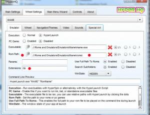

To use the Roms only filter you must fill in the Rom path and extension so Hyperspin knows what to look for and where.
If you plan on using Hypertools it's also a good idea to fill these in.
