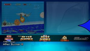

dark13 Posted August 21, 2014 Posted August 21, 2014 As far as I know it's impossible to change the location of hyperspin rom's info but it is possibile to hide it. The question is: is there a third party software capable of overlaying text on hyperspin while browsing games? I'm preparing a 16:9 htpc layout and making infos as layers would be a pain especially on mame (a .png each rom)... so, it is possible to read it from .xml and select where to place lines? This is a quick test sketch, basically in this case i would like infos on the right panel Automatizing infopanels creation from .csv files for HTPCs themes (look at infopanel tutorial.zip on the ftp in dark13 folder) PNGs to SWFs automatized flash scripts Hyperspin Wheelset automatized template (photoshop's variables + batch) Aeon nox 4.13 W.I.P. hyperspin skin
ghutch92 Posted August 21, 2014 Posted August 21, 2014 You should be able to move that text "1987, Sega AfterBurner II" and even change the color and font since the settings are all there. Look in HyperSpin\Settings\%systemname%.ini and then look for the section [Game Text]. How to Install HyperSpin and more RocketLauncher HyperSpin Startup Script
dark13 Posted August 21, 2014 Author Posted August 21, 2014 E pur si muove I tought it was impossible But there seems to be a problem: in mame's .xml is listed "TEXT1"= rom's title and "TEXT2"= year AND manufacture. Is this done trought an .xml's line that specify which information is linke to text1 and text2? If so I guess it's possible to add a text3... Automatizing infopanels creation from .csv files for HTPCs themes (look at infopanel tutorial.zip on the ftp in dark13 folder) PNGs to SWFs automatized flash scripts Hyperspin Wheelset automatized template (photoshop's variables + batch) Aeon nox 4.13 W.I.P. hyperspin skin
ghutch92 Posted August 21, 2014 Posted August 21, 2014 <description> is linked to text 1 <year>, <manufacturer> is linked to text 2 As far as I know there is no changing this or adding new ones, although it may be possible. How to Install HyperSpin and more RocketLauncher HyperSpin Startup Script
