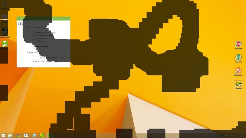

Good call man! I literally got a response from a YouTube a few hours after I posted. Said the same thing. Right on! But let me pick your brain with this one... Why is the touchmote pointer leaving trails of black transparent boxes all over my screen? Very strange problem indeed.
Answered my own question... I have a laptop with a Nvidia 755M gpu plus Intel 4600 gpu. I had the preferred gpu default set to NVidia 755M gpu under the Nvidia Control Panel. So everything I install runs off the Nvidia 755M gpu. When I manually set Touchmote to use the internal Intel 4600 gpu the problem was resolved.
