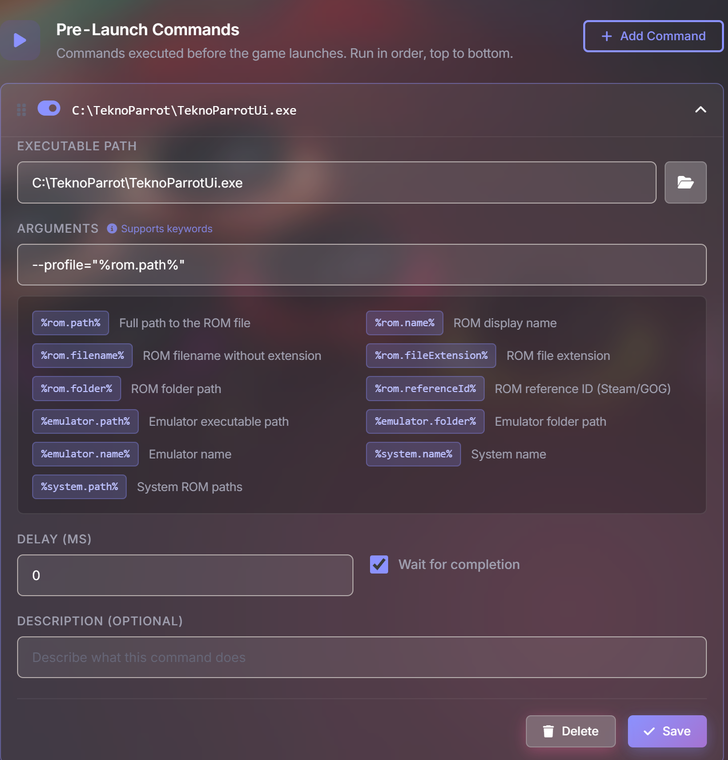

OK Did the setup from scratch...  Pointed at my folder
Even added the things shown in @Fraggle99's list
Why it has the Emulator as Reroarch I have no idea but that is what happened when going through the wizard.
Games do not launch from HQ or HS
What did I miss guys?
hi
Change your default emulator to technoparrotUI
System
Edit
Default Emulator
Change from retroarch to technoparrotUI
and save.
