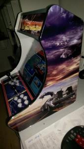

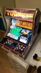

HazzardActual Posted September 1, 2014 Posted September 1, 2014 looks great dude, i like the side art. What size screen? 21? What is there left to do?
Ridu83 Posted September 1, 2014 Author Posted September 1, 2014 It´s a 19" LCD 4:3 screen. It runs on a Intel E8400 3.0 Dualcore, Geforce GTX 650 , 4 gig ram and a be quiet powersupply. Also installed 2 wireless xbox controllers which can be used when needed. Mortal Kombat9 runs great on it. I have to replace the keyencoder by an i-pac. and the bezel wasnt finished
HazzardActual Posted September 1, 2014 Posted September 1, 2014 Looks like you're not gonna have much of a bezel. That screen looks waaaaay bigger than a 19, the way that its set up now makes the monitor really pop. Im about to start building mine in a very similar configuration. Im using an old laptop that im hoping to build a drawer under the controls for accessibility.

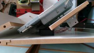

Ridu83 Posted September 2, 2014 Author Posted September 2, 2014 Yes. Ist About 2 cm for the bezel. In the Top the screen just fits and there is no more space for a bezel. It was very tricky to get the LCD fitting in the bartop. Had to remove the plastic aruond it.

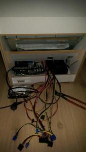

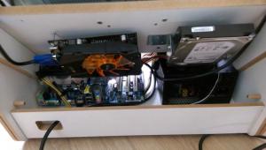

monkeychunkuk Posted September 2, 2014 Posted September 2, 2014 Great work any chance of some pictures of what's inside Sent from the smut hut
Ridu83 Posted September 2, 2014 Author Posted September 2, 2014 Yes i am gonna Post sine pictures Ehen i am home. The TFT is a syncmaster.
Ridu83 Posted September 3, 2014 Author Posted September 3, 2014 Here they are. You see, there's almost no more room
monkeychunkuk Posted September 3, 2014 Posted September 3, 2014 Thank you I didn't know you could run a ribbon cable to a graphics card ? Sent from the smut hut
Ridu83 Posted September 3, 2014 Author Posted September 3, 2014 Yeah. It's called pcie Raiser. That was the most tricky part to get it done .
