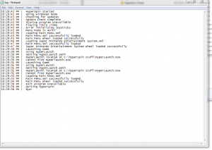

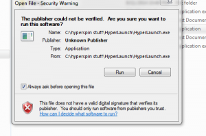

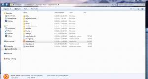

ghutch92 Posted September 5, 2014 Posted September 5, 2014 Make sure you are using HyperSpin.exe v1.3.2 as well. Can you take a screen shot of the folder your hyperlaunch.exe is in? How to Install HyperSpin and more RocketLauncher HyperSpin Startup Script
taken123 Posted September 12, 2014 Author Posted September 12, 2014 Hey sorry i took me so long to respond yea i will send you a few
taken123 Posted September 12, 2014 Author Posted September 12, 2014 i think this is what your asking for sorry not very good a comp stuff
ghutch92 Posted September 12, 2014 Posted September 12, 2014 based on your screenshot this is incorrect Hyperlaunch_Path=C:\Hyperspin\HyperLaunch\ it should be Hyperlaunch_Path=C:\hyperspin stuff\HyperLaunch\ If this fixed it, your error was you kept telling hyperspin to find hyperlaunch at the wrong address. How to Install HyperSpin and more RocketLauncher HyperSpin Startup Script
