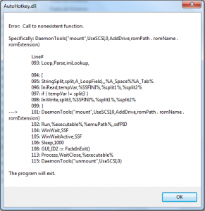

Pollux Posted March 25, 2013 Posted March 25, 2013 Thanks a lot for this usefull tutorial and all the doubts this thread cleared. I've done everything as told here but I got an error running SSF (Version 0.12 beta R3 (12/25/2011)) script. When I try to run it pops up this window: Here's my Hyperlunch Log: 11:42:39 | HyperLaunch v2.24e 11:42:39 | System Specs: HyperSpin Dir: C:\HyperSpin OS: WIN_7 OS Language: 0816 OS Admin Status: No Monitor #1 (\\.\DISPLAY1): 1366x768 (1366x728 work) HyperSpin Res: 1025x526 AHK Version: 1.1.07.03 11:42:39 | HyperLaunch launched directly 11:42:42 | HyperLaunch received "Sega Saturn" and "SEGARALLY" 11:42:42 | INI Keys read 11:42:42 | Checking paths 11:42:42 | Finished injecting functions into module 11:42:42 | Module is built 11:42:42 | Running module: ;----------------------------------------------------------- ;Built in script ;----------------------------------------------------------- #NoTrayIcon DetectHiddenWindows, ON SetTitleMatchMode, 2 SendMode, Event 0 = 0 exitEmulatorKey = ~Esc emuPath = C:\HyperSpin\Emulators\Sega Saturn\Emuladores\SSF_012_beta_R3\ romPath = C:\HyperSpin\Emulators\Sega Saturn\Roms\S\SEGARALLY\ romExtension = .cue romExtensions = mds,cue,iso,cdi,nrg,img executable = SSF.exe systemName = Sega Saturn romName = SEGARALLY daemonToolsPath = C:\Program Files (x86)\DAEMON Tools Lite\DTLite.exe skipchecks = false fadeIn = fadeOut = fadeColor = fadeInDuration = fadeOutDuration = fadeInDelay = fadeInInterruptKeys = {LControl}{RControl}{LAlt}{RAlt}{LShift}{RShift}{LWin}{RWin}{AppsKey}{F1}{F2}{F3}{F4}{F5}{F6}{F7}{F8}{F9}{F10}{F11}{F12}{Left}{Right}{Up}{Down}{Home}{End}{PgUp}{PgDn}{Del}{Ins}{BS}{Capslock}{Numlock}{PrintScreen}{Pause} gameStartImgPath = C:\HyperSpin\Media\Sega Saturn\Images\GameStart\ 7zEnable = false 7zExtractDir = C:\Users\FILIPE~1\AppData\Local\Temp\Hyperspin\ 7zDelTemp = true 7zFormats = .zip,.rar,.7z,.gzip,.tar 7zFormatsNoP = zip,rar,7z,gzip,tar Hotkey, ~Esc, CloseProcess ;----------------------------------------------------------- ;Module script ;----------------------------------------------------------- ;------------------------------------------------------------------------ ; Sega Saturn ; SSF v0.12 beta R3 (12/25/2011) ; by djvj ; 1.4 ; ; Notes: ; This only works with DTLite, not DTPro ; Make sure your Path_To_Daemontools in Settings\settings.ini is correct ; romExtension should be mds,cue,iso,cdi,nrg ; Make sure you have your CDDrive set to whatever number you use for your games. 0 may be your hardware drive, while 1 may be your virtual drive (depending on how many you have). If you get a black screen, try different numbers starting from 0. ; If you keep getting the CD Player BIOS screen, you have the CDDrive variable set wrong below ; If you keep getting the CD Player screen with the message "Game disc unsuitable for this system", you have the incorrect bios set for the region game you are playing and or region is set wrong in the emu options. Or you can just turn off the BIOS below ; Set fullscreen mode via the variable below ; SSF forces 1024x768 in fullscreen mode and cannot be changed as far as I can tell ; If you are getting clipping, set the vSync variable to true below ; For faster MultiGame switching, keep the BIOS off, otherwise you have to "play" the disc each time you switch discs ;------------------------------------------------------------------------ Fullscreen = true ShowBIOS = false BilinearFiltering = true vSync = true WideScreen = false Stretch = false CDDrive = 1 UseSCSI = false ; If you prefer SCSI virtual drives, set this to true, otherwise Daemon Tools will use a DT virtual drive. AddDrive = true ; If you do not have a scsi or dt drive in daemon tools, it will be created for you. Set this to false to stop auto-creation of the drive. ;------------------------------------------------------------------------ SSFINI := CheckFile(emuPath . "SSF.ini") GUI_ID := FadeInStart() 7z1 := 7z(romPath, romName, romExtension, 7zExtractDir) mySW:=A_ScreenWidth, mySH:=A_ScreenHeight ; Now let's update all our keys if they differ in the ini Fullscreen := (If ( Fullscreen = "true" ) ? ("1") : ("0")) ShowBIOS := (If ( ShowBIOS = "true" ) ? ("0") : ("1")) BilinearFiltering := (If ( BilinearFiltering = "true" ) ? ("1") : ("0")) vSync := (If ( vSync = "true" ) ? ("1") : ("0")) WideScreen := (If ( WideScreen = "true" ) ? ("1") : ("0")) Stretch := (If ( Stretch = "true" ) ? ("1") : ("0")) UseSCSI := (If UseSCSI = "true" ? ("scsi") : ("dt")) iniLookup = ( ltrim c Screen, FullSize, "%Fullscreen%" Screen, BilinearFiltering, "%BilinearFiltering%" Screen, VSynchWaitFullscreen, "%vSync%" Screen, WideScreen, "%WideScreen%" Screen, StretchScreen, "%Stretch%" Screen, EnforceAspectRatioFullscreen, "1" Peripheral, CDDrive, "%CDDrive%" Program4, NoBIOS, "%ShowBIOS%" Other, ScreenMode, "%Fullscreen%" ) Loop, Parse, iniLookup, `n { StringSplit, split, A_LoopField, `,, %A_Space%%A_Tab% IniRead, tempVar, %SSFINI%, %split1%, %split2% If ( tempVar != split3 ) IniWrite, % split3, %SSFINI%, %split1%, %split2% } DaemonTools("mount",UseSCSI,0,AddDrive,romPath . romName . romExtension) Run, %executable%, %emuPath%,,ssfPID WinWait, SSF WinWaitActive, SSF Sleep, 1000 ; SSF flashes in real fast before going fullscreen if this is not here GUI_ID2 := FadeInExit() ; WinMove,SSF,,0,0 ; uncomment me if you turned off fullscreen mode and cannot see the emu, but hear it in the background Process, WaitClose, %executable% DaemonTools("unmount",UseSCSI,0) 7z2 := 7zCleanUp() GUI_ID4 := FadeOutExit() WinActivate, Hyperspin ExitApp PreMultiGame: If Fullscreen = 1 ; only have to take the emu out of fullscreen we are using it { ; SSF cannot swap discs in fullscreen mode, so we have to go windowed first, swap, and restore fullscreen WinGet, ssfID, ID, A WinGetPos,,,ssfW,ssfH,ahk_id %ssfID% SetKeyDelay,,10 Send !{Enter} WinSet, Transparent, 0, ahk_id %ssfID% If (mySW != ssfW || mySH != ssfH) { ; if our screen not the same size as SSF uses for it's fullscreen, we can detect when it changes While % ssfH = ssfHn { WinGetPos,,,,ssfHn,ahk_id %ssfID% Sleep, 100 } } Else ; if our screen is the same size as SSF uses for it's fullscreen, use a sleep instead Sleep, 3000 ; increase me if MG GUI is showing tiny instead of the full screen size tempgui() } Return MultiGame: If !mgCancel { WinMenuSelectItem,ahk_id %ssfID%,,Hardware,CD Open DaemonTools("unmount",UseSCSI,0) DaemonTools("mount",UseSCSI,0,AddDrive,selectedRom) WinMenuSelectItem,ahk_id %ssfID%,,Hardware,CD Close If Fullscreen = 1 { Loop { ; looping until SSF is done loading the new disc Sleep, 200 WinGetTitle, winTitle, ahk_id %ssfID% StringSplit, T, winTitle, %A_Space%: ; ToolTip, %A_Index%`nT10=%T10%,0,0 If !oldT10 ; get the current T10 as soon as it exists and store it oldT10:=T10 If (T10 > oldT10) ; If T10 starts incrementing, we know SSF has a game loaded and can continue the script Break } WinActivate, ahk_id %ssfID% SetKeyDelay,,10 Send !{Enter} Sleep, 500 ; give SSF a moment to go fullscreen and not show Hyperspin Gui, 69: Destroy WinSet, Transparent, 255, ahk_id %ssfID% WinSet, Transparent, Off, ahk_id %ssfID% } } Return CloseProcess: GUI_ID3 := FadeOutStart() WinClose, SSF Return tempgui(){ Gui, 69:Color, 000000 Gui, 69:-Caption +ToolWindow Gui, 69:Show, x0 y0 W%A_ScreenWidth% H%A_ScreenHeight%, BlackScreen } hideDesktop(){ } FadeInStart(){ } FadeInExit(){ } FadeOutStart(){ Suspend, On } FadeOutExit(){ } 7z(path, name, ext, extractPath){ } 7zCleanUp() { } CheckFile(file,msg="",timeout=6){ IfNotExist, %file% { If msg ScriptError(msg, timeout) Else ScriptError("Cannot find " . file, timeout) } Return %file% } ScriptError(error,timeout=6){ MsgBox,48,Error,%error%,%timeout% ExitApp } 11:42:44 | Module ended, exiting HyperLaunch normally However I tried to run SSF & Yabause (Version 08/27/11 & 0.9.10) Script and I managed to get it to work. Unfortunately when it starts I get my region set to Japan and CDDrive=0 instead of Europe and CDDrive=1 as I set up. If I could change this inside the script I think I could get the game started but I've searched a lot and got no answer for this. Can everyone give a hand in this? Thanks in advance!
brolly Posted March 25, 2013 Posted March 25, 2013 Update to the latest HL as you are not using it...
Pollux Posted March 25, 2013 Posted March 25, 2013 Really...?! I saw this thread HyperLaunch-2-x-Released but I didn't found any link to it so I couldn't upgrade it. I presume it's only avaiable for lifetime users? I'm saving some money this month to get a platinum member... I guess until then I cannot try this again, right? And what about the other script region problem? Any hint? Thanks in advance!

Pollux Posted March 26, 2013 Posted March 26, 2013 HyperLaunch is available to all users, you can download it from HyperList. Regarding the region, there is the hard/purist way which involves editing the module or the easy way which simple requires you to use the multinorm bios that will run games from all images. Google it. I got that BIOS already (without knowing it). Meanwhile, I updated my HyperLaunch and now DT load the game but the emulator shows a black screen or the Direct3D9 error... ps: brolly are you portuguese?
brolly Posted March 26, 2013 Posted March 26, 2013 Well, first thing make sure you get it working fine outside HS. Also if you need CDDrive=0 you must change that in the module or it won't work. Yeah I'm portuguese.
Pollux Posted March 26, 2013 Posted March 26, 2013 Well, first thing make sure you get it working fine outside HS. Also if you need CDDrive=0 you must change that in the module or it won't work. OK... My SFF is running fine outside HS. CDDrive is set to 1 because 0 is my physical one. Now I must compile my Hyperlaunch.ahk with AHK.H but I can't download the file form the link provided because Avast pop up a trojan alert... If I compile HyperLaunch directly I start getting those errors... brolly do you mind if I PM you in our native language with this? I'm really close to get this working but I'm missing things somehow.
brolly Posted March 26, 2013 Posted March 26, 2013 Wait, compile HyperLaunch? You NEVER compile HyperLaunch! Just use the HyperLaunch executable you downloaded, never under any circumstances compile the ahk file. The only scenario where you need to do that is if you need to fix something in the actual HL code which isn't a good idea anyway. I prefer questions to be posted on the forums as the solutions to your problems might be useful for others in the future, but you can pm me, please don't be surprised if I take a while to get back to you as I usually get a lot of questions and simply can't answer them all.
Pollux Posted March 26, 2013 Posted March 26, 2013 Wait, compile HyperLaunch? You NEVER compile HyperLaunch! Just use the HyperLaunch executable you downloaded, never under any circumstances compile the ahk file. The only scenario where you need to do that is if you need to fix something in the actual HL code which isn't a good idea anyway. Now this gets a little bit confusing... I'll tell you what I've done. First I deleted all my AHK and HL files from Hyperspin folder; Then I went to this page (HyperList AHK Scripts) and downloaded HyperLaunch (Version 2.25c); After that I read this in detailed description: "This download contains only the source code and must be compiled with Autohotkey_H only to be used. AutoHotkey.dll is also required." and went to AHK website and tried to get AHK_L version but my antivirus poped up a trojan warning and I installed AHK_L. (Please note that I didn't have found any HL EXE so far) Since I don't have one EXE file for HL I downloaded all missing files as I was asked for. After that I got the "backslash missing error" but I got everything right in INI files. Trying to solve this problem warning changed to the DX error. I downloaded it and I'm up to date now. Last but not least after reading your post I deleted all files again and uninstalled AHK. Now I have SFF running fine outside HS and I'll wait for any community post telling I'm doing the right thing or telling me how to do it right.
brolly Posted March 26, 2013 Posted March 26, 2013 Ok, start by reading this post here: http://www.hyperspin-fe.com/forum/showthread.php?10709-HyperLaunch-2-x-Released At the end of that post you'll find the HyperLaunch executable and all the files you need to use (make sure you use the Autohotkey.dll file that comes bundled with it and not any other), that's the one you should always use, you don't need to compile anything, you don't even need to have ahk installed in your machine. Lmk if you still have issues after doing this, at least then we know you're using the correct versions of everything.
