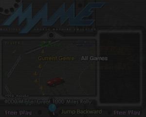

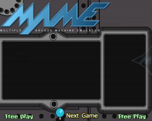

avisioncame Posted September 24, 2014 Author Posted September 24, 2014 Attached are screenshots of what I am experiencing. Note the the first image. As I scroll through games, the titles overlap each other.
scooter1974 Posted September 24, 2014 Posted September 24, 2014 There could be some applications that you are using in HyperSpin that have stored information on your "Documents" drive, in the app data folder. Just a guess, but wouldn't hurt to have a look. Check out my MAME Arcade classics themes!
avisioncame Posted September 24, 2014 Author Posted September 24, 2014 Hmm...good tip... The only "application" I can think of that is currently running with Hyperspin is Project64... but as I currently have the wheel set to MAME only should that matter? Can you think of a typical application that would be running adjacent to HS that I am not thinking of? I tried setting it back to have the intro wheel with all my different emulators. I can scroll through the emulators, but when I try to select one, it just "resets" the screen (imagine hitting the back button while in a specific wheel, how it takes you back to the main wheel, looks like that).
avisioncame Posted September 25, 2014 Author Posted September 25, 2014 Just wanted to update this problem as FIXED! Did some searching around, finally found someone with a similar problem to mine. Even after a clean install of HS it was doing the exact same thing. The answer was to INSTALL MY SOUND CARD DRIVER! Weird, I know, but it worked. Everything is smooth now!
