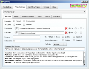

rfancella Posted September 29, 2014 Posted September 29, 2014 HzerbThaWizherb said: Anyone know how to get one of these to work in hyperspin. I have the wheel settings all ready to go and set the .exe to run without hyperlaunch. My mian problem is i have no clue how to write an .ahk for one of these programs. Any help would be appreciated, would really love to start organizing a comic collection for my cab. Hello and welcome to the forums! If you have it set to not user HyperLaunch, you don't need an ahk module. Just point HyperHQ (not HyperLaunchHQ) to your viewer as the emulator, and the correct directory for your roms (mags). Here is what my screen looks like for my Nintendo Power wheel: Thanks, Ron Code Monkey and all around Command Line geek!If you like what someone has said or done for you, be sure and 'Thank' them. And if they changed your life, send them a Beer!
